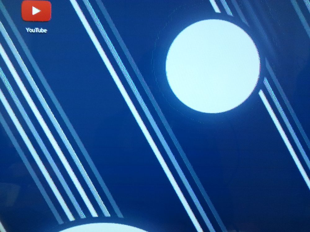

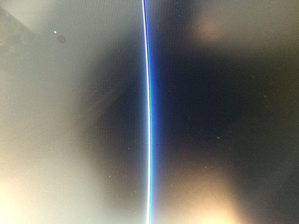

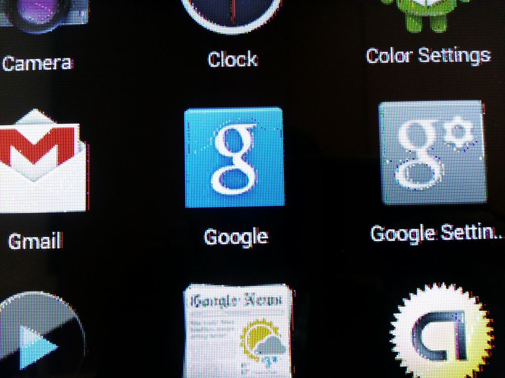

We are using custom hardware based on IMX6q.
LVDS panel is connected to hardware and some times we are getting display corruption.
How we can fixed this issue? What could be the reason behind this?

This issue occurs randomly. After reboot or suspend resume this issue disappear and visa verse.
I am using 1080p display Panel.

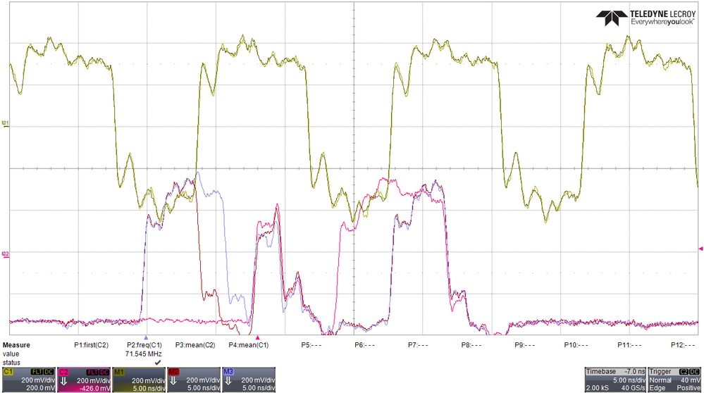

I have the same issue and i have solved it with your settings. Thank you. I would like to give some more information about what i saw. First i made a .bmp picture with only one pixel RGB colour = 127, 127 and 127. Then I send the whole picture to the screen using the following linux command:
dd if=/media/sda1/test.bmp bs=138 skip=1 > /dev/fb (The test image is a 1280x800 RGB565 bitmap file)
We then saw a shift in pixels:
When setting the following setting: addr 0x02640008 to 0x00020001 (was 0x00010000), the problem was fixed.
Below a measurement of the LVDS signals, CLK and RX1:
Red and blue are the incorrect image with shifted bits. Pink is the correct image.
