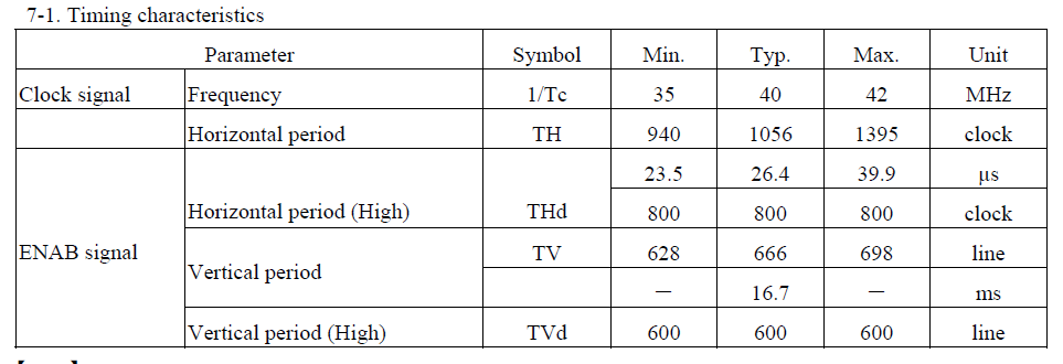

I use IMX6DL, Kernel3.14.52, Uboot2015.04. Now I'm porting one LCD which is LVDS port. Follow is its timing.

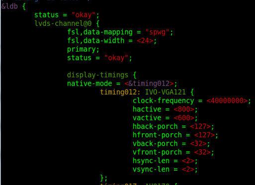

My device tree config is follow:

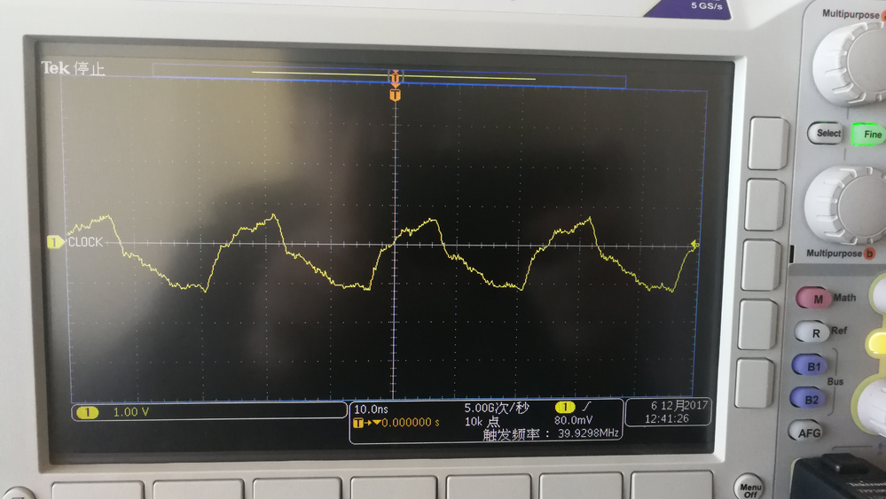

I also check waveform from scope , clock is 39.9MHz

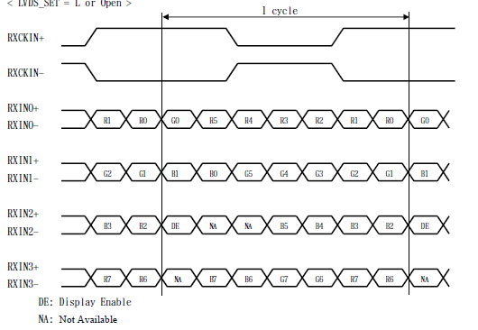

The waveform of your display seems to be equal from the one we use as default on i.MX6 SabreSD board. We use HSD100PXN1 from Hannstar.
About the timings, there are missing information on your table. As example, please check the document attached.

Thanks for your reply. I tested add <de-active> <pixelclk-active> <vsync-active > <hsync-active>  and change diffrent value, but the result is same to previous test.

Hi leavs
one can change fsl,data-width = <18>; and select appropriate kernel boot parameter
using Table 11. Common kernel boot parameters attached Release Notes,

Hi igorpadykov,
I had tested the data-width = <18>, but it didn't work. Do you have any other idea?
