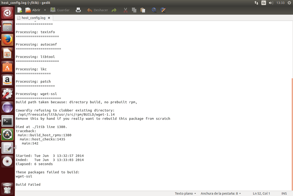

hi.
after run ./ltib this is the message  I read in the host_config.log. can anybory help me with this?
thanks !
Processing platform: Host support packages
using /home/david/ltib/config/platform/host/ltib.preconfig
Processing: fake-provides
Processing: mkspooflinks
Processing: distcc
Processing: ccache
Processing: bison
Processing: flex
Processing: texinfo
Processing: autoconf
Processing: libtool
Processing: lkc
Processing: patch
Processing: wget-ssl
Build path taken because: directory build, no prebuilt rpm,
Cowardly refusing to clobber existing directory:
/opt/ltib/usr/src/rpm/BUILD/wget-1.14
Remove this by hand if you really want to rebuild this package from scratch
Died at ./ltib line 1492.
traceback:
main::build_host_rpms:1492
  main::host_checks:1554
   main:562

Have you tried removing /opt/ltib/usr/src/rpm/BUILD/wget-1.14 ??
10,608 Views
davidmartinez
yes, but I obtain teh same message after I run ./ltib an check the file host_config.log
I'm usign ubuntu 14.04.

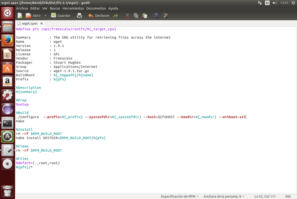

Please try this:
a) go to dist/lfs-5.1/wget and edit wget.spec: add --without-ssl to the end of the ./configure line
b) delete /opt/ltib/usr/src/rpm/BUILD/wget-1.14
c) run ./ltib again
10,608 Views
davidmartinez
I check teh line you said me, but was added (--without-ssl) . en I run again and the same message appear  :smileysad:.
I working with the HHH (Home health hub) this platform use a imx283, is there another diferent tool to the LTIB to create the projects embbeded in the processor?

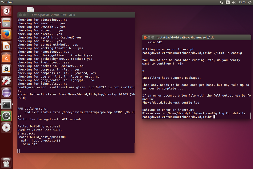

The "Cowardly refusing to clobber existing directory: /opt/ltib/usr/src/rpm/BUILD/wget-1.14" error will disappear once you have successfully deleted that folder (sudo rm -rf /opt/ltib/usr/src/rpm/BUILD/wget-1.14).
Please post the error you get, after deleting the folder and running LTIB again.
I have recently built the full MX28 LTIB BSP (L2.6.35_1.1.0_130130_source.tar.gz) from scratch, using Ubuntu 14.04.
10,608 Views
davidmartinez
this is that I obtain when remove the file and run again the ./ltib , and wait for a long time then is showing the message in the left terminal.
10,608 Views
RodBorras
The log says you used"--with-ssl" instead of "--without-ssl".
Please:
- double check that you actually did put without instead of with, and try it again
- if that does not work, please revert back to the original wget.spec and try this again.
Thanks.
10,608 Views
davidmartinez
hi!
these are the files that I changed (wget.spec) and checked (host_config.log) after run ./ltib. I added the comand you said me but the same issue appear.
10,608 Views

admax
Hi!
Neither Installing additional packages, nor removing wget-source won't help. This happens because wget can't compile it's manpage with perl5.18. So you can either install perl5.17, or patch wget sources. I haven't tried downgrading to perl5.17, but tried patching, and it worked for me, so sharing it with you as tiny Bash script for convenience (it fixes wget-ssl.spec along with wget.texi).
Copy-paste command for lazies:
wget -qO- https://gist.github.com/the-admax/684d56db33f2f0792b69/raw/be70219025a11c97037b0e423f961b776cd3d418/... | bash
After it's done its work just run
ltib --hostcf
