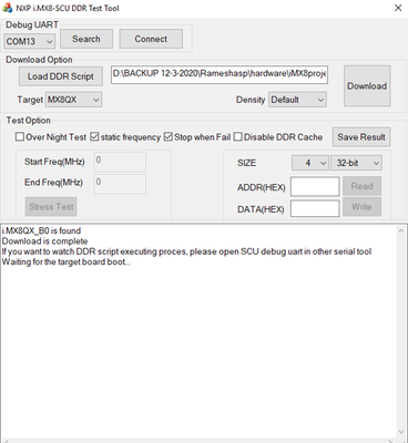

I am using MT53E768M32D4DT-053 AIT:E LPDDR4 in my custom board and processor is used i.MX8QXP.
I am using the attached RPA file but i am getting below error. Debug log also attached for your reference, we got errors in this log also.
I checked with Micron, he has suggested to change in the register values, below is the details:
"Slightly tune VrefCA, VrefDQ, Drive Strength, ODT; Check tRFC compatible or not.
 All DRAM registers could be written from controller software: VrefCA is in DRAM register MR12, VrefDQ is in DRAM MR14; Write ODT is in DRAM MR11 and MR22, Read ODT is not in DRAM but in controller side registers; Read Drive Strength is in DRAM MR3, Write Drive Strength is not in DRAM but in controller side registers; Read latency RL and Write latency WL are in DRAM MR2."
Can you please provide the updated RPA file with respect to the Micron team feedback.
we need to resolve this issue immediately as the SOM board integration is blocked on this LPDDR4 issue.

sai_jyothi
Hi Igor,
Is UART2 port of iMX8QXP is A35 debug port, confirm. If not, provide the port details.
UART details: I have connected 3 UART's (UART0, M40_UART0 & UART2) while doing DDR calibration test. Please confirm whether this UART's are correct or not.
I have attached the DDR stress tool which I used.
Can you provide the correct mx8qx_scfw_download.bin or mx8qxb0_scfw_download.bin files.
Reference schematic we used is :SPF-29683-C2
Please provide the boot setting details while doing DDR test.
We have used NXP's default SCFW for the custom board, because we are using same LPDDR4 as EVK.

sai_jyothi
I have attached SCU_UART_debug information image. We have not getting as expected in our custom board compared to EVK board.
Please provide the SCFM firmware loading procedure.
