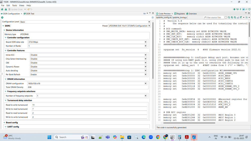

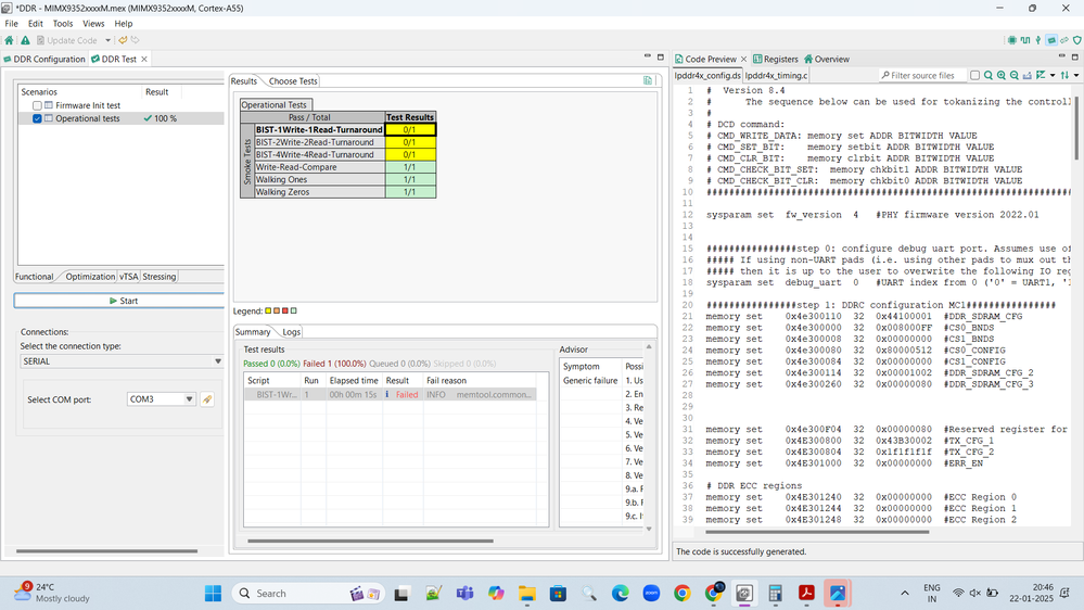

I am working with the Maaxboard OSM93 (Avnet) and testing the LPDDR scenarios. While testing the LPDDR, the operational test results for the following scenarios have failed:
  1. BIST - 1 write - 1 read turnaround
  2. BIST - 2 write - 2 read turnaround
  3. BIST - 4 write - 4 read turnaround
How can I debug these scenarios? What configurations do I need to change? Please suggest the steps to pass all the test scenarios.

Hi @JorgeCas ,
     I used the same LPDDR4 Configuration w.r.t specific maaxboard osm93 board but still in the DDR Tool (v24.12). As I mentioned before, all three test scenarios are failed to pass. So, whether all turnaround cases are mandatory to pass ? Or What does the configuration do I need to follow for that to pass? Or By default, those test scenarios are are failed ? or Only Read-write compare. Walking Zeros, Walking Ones works/get pass because in the User guide of the DDR Tool mentioned these three, so Please clarify the doubts.

Yes, it is mandatory to pass all the tests in DDR stress. It seems that it is not passing Write-Read-Compare test.
Please check that you are entering the corresponding DDR features, PMIC and UART settings.
Could you please share the board characteristics, .mex file and log?

Hi @JorgeCas,
As per the Avnet board, 100% the test is passing with Read - Write compare scenario.
But it's not passing the all other turnaround test case.

JorgeCas
Please try again selecting the exact i.MX part number and DDR technology, according to the board web page, it has a LPDDR4, and you are running the test for a LPDDR4X.
