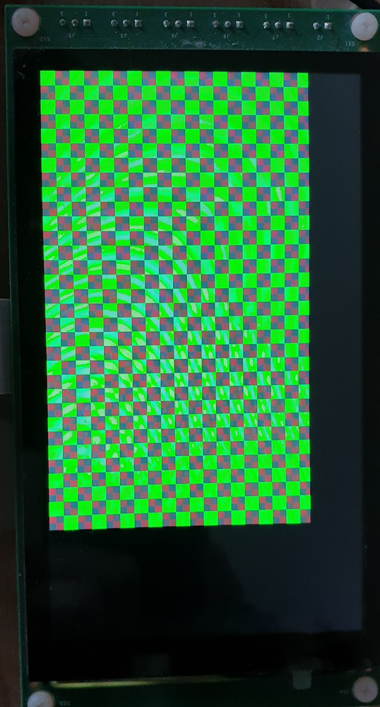

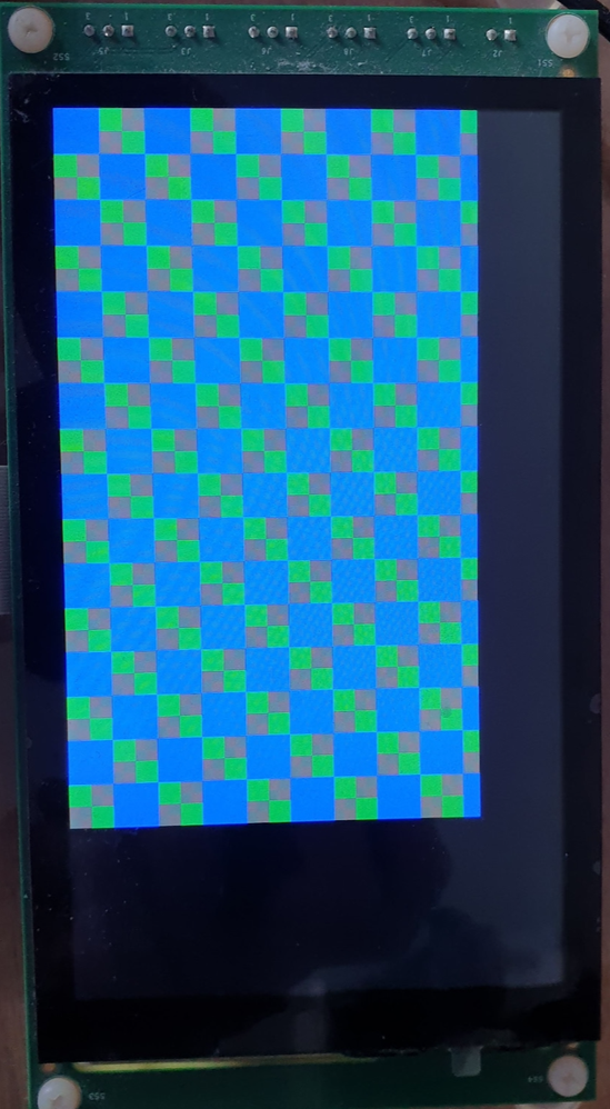

I have enclosed an example for the PXP offline blending.
It is based on the SDK 2.10.1, LCDIFv2 blend example. I tested it with IAR compiler. You need to increase the size of the non-cacheable memory as you have more buffers for the test.
I display it on an 1280x720 display @ 60Hz.
I have 3x 600x1024 ARGB plane in SDRAM (different size chessmate with alpha transparency)
I blend 2x RGBA buffer in RGB with the PXP (offline blending):
With the LCDIFv2 I blend the latest RGBA  layer & the RGB layer generated by the PXP:
PXP blending lasts around 27ms (#37fps), and if you use the PXP with 16pix*16pix transfers (8*8 in the current sw)  you go down to #20ms (50fps):
