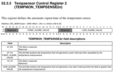

I saw the register 'Tempsensor Control Register 2' to which I can set 'LOW_ALARM_VALUE' . Please the register details.
Address: 20C_8000h base + 290h offset + (4d × i), where i=0d to 3d .
I saw in the linux driver that the register value is 290h+4. It indicates the variable i is 1 and the value setting to this register is 0xfff. From the experiments I understood that this setting is for zero degree celcius (As per our testing with the help of chamber. We are seeing the warning/error kernel prints on boot up whenever temperature is on or below zero degree celcius).
What is the mechanism for setting the 'LOW_ALARM_VALUE' to -35 degrees.

Writing to the Address: 20C_8000h base + 290h offset + (4d × i), where i=0d to 3d .
I am getting a value 0xfff while reading the address. REG_SET value is 0x4.
In this case, kernel warnings are coming below zero degree celcius.
Driver is not reading temperature zone value from dtsi file and dtsi file does not contains temperature zones also.
