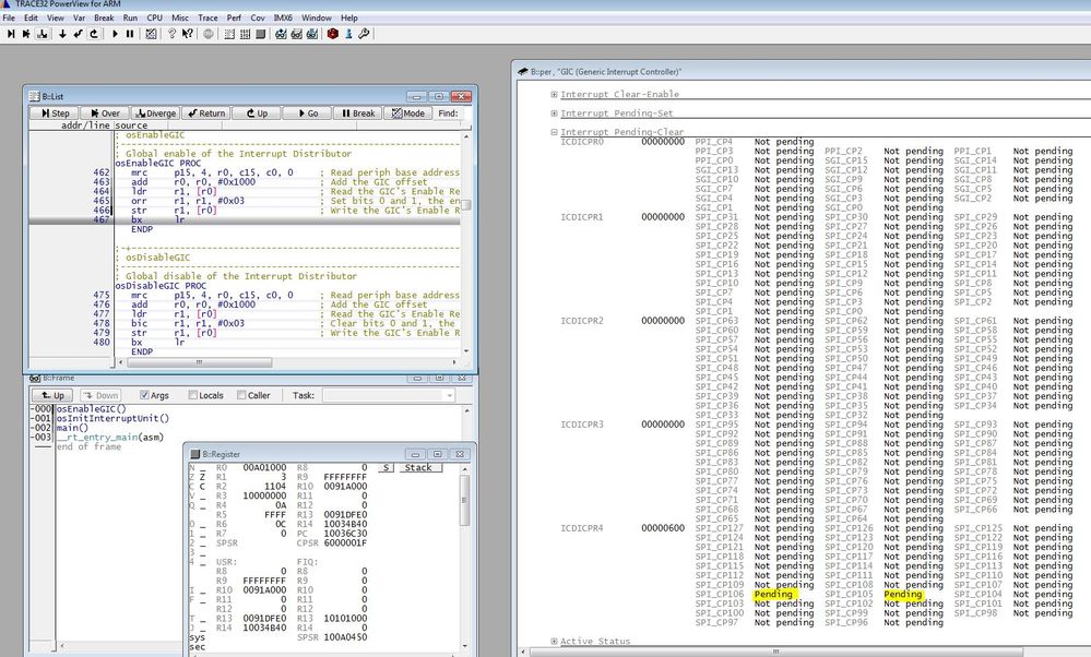

I've added a while loop to our startup code to let me the possibility to debug this issue from the beginning of execution.
I've observed that as soon as the GIC is enabled (0x3 to ICDDCR register), interrupts related to CAAM are set to Pending which is for me suspect.
Before Enabling the GIC:
Right after Enabling the GIC:
This is suspicious for me and I am wondering why it happens since we are at the very beginning of the execution. Can you confirm this behavior on you side ?
Thank you,
Jeremy

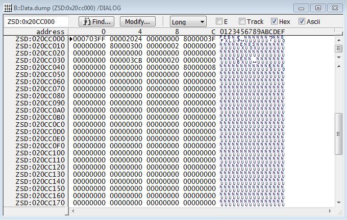

I've added logs to show the content of all SNVS related registers (before attaching Secure JTAG on a closed board):
<2018-04-09> <08:36:29.477> HPLR 0x020CC000- 0x703FF
<2018-04-09> <08:36:29.478> HPCOMR 0x020CC004- 0x2024
<2018-04-09> <08:36:29.478> HPCR 0x020CC008- 0x0
<2018-04-09> <08:36:29.478> HPSR 0x020CC014- 0x80000F00
<2018-04-09> <08:36:29.479> HPRTCMR 0x020CC024- 0x0
<2018-04-09> <08:36:29.479> HPRTCLR 0x020CC028- 0x0
<2018-04-09> <08:36:29.479> HPTAMR 0x020CC02C- 0x0
<2018-04-09> <08:36:29.479> HPTALR 0x020CC030- 0x0
<2018-04-09> <08:36:29.479> LPLR 0x020CC034- 0x3CB
<2018-04-09> <08:36:29.480> LPCR 0x020CC038- 0x20
<2018-04-09> <08:36:29.480> LPSR 0x020CC04C- 0x80000008
<2018-04-09> <08:36:29.480> LPSMCMR 0x020CC05C- 0x0
<2018-04-09> <08:36:29.480> LPSMCLR 0x020CC060- 0x0
<2018-04-09> <08:36:29.480> LPGPR 0x020CC068- 0x0
<2018-04-09> <08:36:29.480> HPVIDR1 0x020CCBF8- 0x3E0100
<2018-04-09> <08:36:29.481> HPVIDDR2 0x020CCBFC- 0x0
And then I have dumped the memory from 0x020CC000 after I attached Secure JTAG on the same closed board:snvs_registers_after_attachment_closed config.JPG
Thank you,
Jeremy
