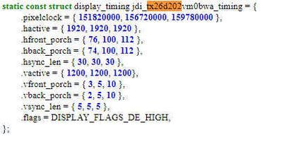

Can you attach the kernel drm log(need to open drm debug mode) and android log?
for 1920x720 seems it is necessary to add lcd panel info, as in jdi wuxga
fsl-imx8qxp-mek-jdi-wuxga-lvds0-panel.dts example:
compatible = "jdi,tx26d202vm0bwa
