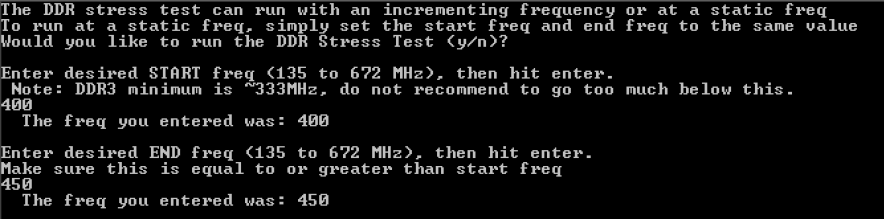

     I'm so confused about some concepts regarding the freq. One is arm core speed,another is DDR freq. And when I run the DDR stress tool, we will see as follow:
And the MMDC support the max freq is 400MHz, Why can we change the freq to more than 400MHz,such as 672MHz? So the freq here means the Arm core speed?

  The DDR stress test is non-OS tool to check how robust DRAM interface is,
given current set of parameters (i.e. drive strength settings, timing parameters,
board layout, etc), therefore it implements testing even out of the specified
operation range. The test allows to provide checking for DDR frequencies
from 135 till 672 MHz.

  The stress tool suppports several devices of i.MX series. Say, the MMDC
of i.MX6Q is specified to work up to 528 MHz. But for testing we can apply
more wide frequency area. As for Linux CPUFREQ feature, it provides
optimal working points regarding core and DDR frequencies, but basically
core and DDR frequencies are independent.
