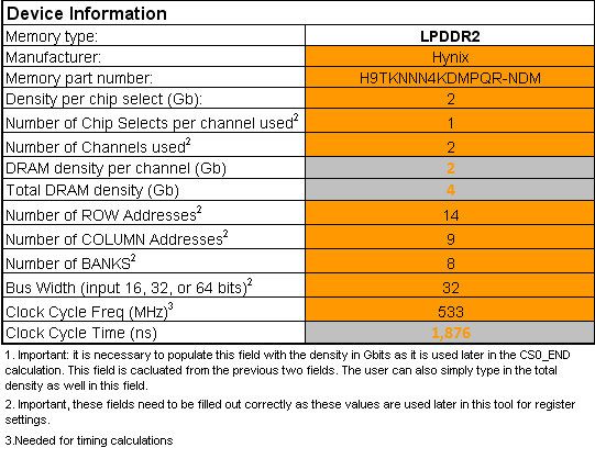

Hi,All
       in i.Mx6SL LPDDR2 Script Aid ,some  configuration options is confused. Because my LPDDR2  total density is 512Mb, DRAM single die density (Gb)DRAM density(Gb)DRAM density per CS (Gb) , how to fill in these blanks? 3Q~

Hi tony
one can look at example below
and other lpddr2 init examples in SDK
i.MX 6Series Platform SDK : Bare-metal SDK
Interleaved LPDDR2 Memory on i.MX6Dual
i.Mx6DQSDL LPDDR2 Script Aid
igor
