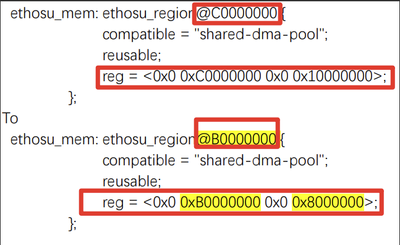

Since we are using 1GB LPDDR4, NPU shared memory size is aligned 128 MB according to the link below.
Note that we fixed ethosu region in kernel as it is described in your docs like the following:
Could this reduced allocation be the cause of the issue? If not, do you have any suggestions for resolving it?
