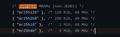

Manuel_Salas
Also, it appears the mr25h40 is a non-JEDEC as you can see on the spi-nor core driver.
But first, please try with the above test.
Salas.

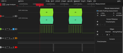

Manuel_Salas
Hello @Maulik_Manvar
I test it by my side without any issue.
I used the device tree as same as you:
&ecspi2 {
	#address-cells = <1>;
	#size-cells = <0>;
	fsl,spi-num-chipselects = <1>;
	pinctrl-names = "default";
	pinctrl-0 = <&pinctrl_ecspi2 &pinctrl_ecspi2_cs>;
	cs-gpios = <&gpio5 13 GPIO_ACTIVE_LOW>;
	status = "okay";
	spidev1: spi@0 {
		reg = <0>;
		compatible = "rohm,dh2228fv";
		spi-max-frequency = <500000>;
pinctrl_ecspi2: ecspi2grp {
		fsl,pins = <
			MX8MP_IOMUXC_ECSPI2_SCLK__ECSPI2_SCLK		0x82
			MX8MP_IOMUXC_ECSPI2_MOSI__ECSPI2_MOSI		0x82
			MX8MP_IOMUXC_ECSPI2_MISO__ECSPI2_MISO		0x82
I used the command:
root@imx8mpevk:~# spidev_test -D /dev/spidev1.0 -s 80000000 -v
And my spi output:
Then:
root@imx8mpevk:~# spidev_test -D /dev/spidev1.0 -s 30000000 -v
SPI has the expected behavior.
Salas.

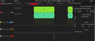

Maulik_Manvar
Hi @Manuel_Salas ,
Thank you so much for experiment the same.
So, Now I can see that, If you set 30MHz using  spidev_test -D /dev/spidev1.0 -s 30000000 -v
and You are getting 26.6MHz as an output frequency can see in DSO snap.
and
If you set 80MHz using  spidev_test -D /dev/spidev1.0 -s 80000000 -v
You are getting 80MHz full as an output frequency can see in DSO snap.
imx8mp default  base clock: ECSPI2 module uses a base clock frequency of 80 MHz, derived from the SYSTEM_PLL1_CLK (800 MHz).
If I set the frequencies to 1MHz, 2MHz, 4MHz, 5MHz, 10MHz, 16MHz, 20MHz, or 40MHz, I observe the full frequency on the DSO without any discrepancies. However, when setting the frequencies to 25 or 30MHz, I get 19.6 and 26.6MHz, respectively.
Could you please explain if there is any impact on the SPI device when the frequency is not exactly 30MHz? I would like to hear your thoughts on this.
Maulik

Manuel_Salas
It appears this is expected, because the SPI subsystem just can divide the clock in integers.
For example, in this case the clock used by SPI is 80MHz, so, dividing by:
80/1 = 80MHz
80/2 = 40MHz
80/3 = 26.66MHz
80/4 = 20MHz
The driver proximate the configured clock on the command with its divider.
There are not issue if the frequency is not exactly 30MHz because your device is UP to 40MHz.
