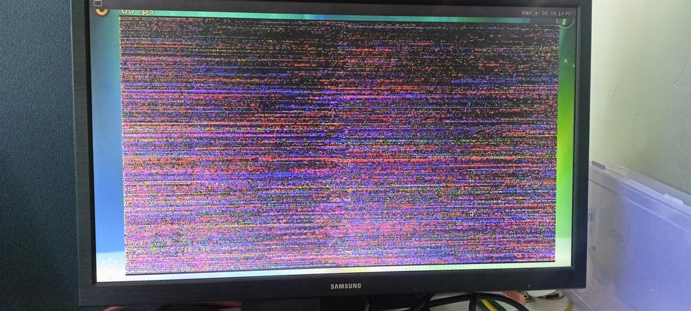

I am currently working on integrating the IMX219 sensor with our custom IMX8MP board, using the ISP configuration.
We have ported the changes from the following repository into our custom Yocto layer: ( 6.6 sacrthgap KERNEL Version )
https://github.com/nxp-imx-support/meta-imx8mp-isp-imx219.
However, when running gst-launch-1.0 or v4l2-ctl commands, we are facing issues:
  • The pipeline captures the first frame with distortion but then gets stuck and does not proceed.
  • The image output is not proper.
Below are the details of our setup:
DTS configuration :

Pipeline Behavior and Logs During Capture: Command:
root@imx8mp-evk:~# gst-launch-1.0 v4l2src device=/dev/video2 ! videoconvert ! autovideosink sync=false
[  239.695562] enter isp_mi_stop
[  239.891296] enter isp_mi_stop
Setting pipeline to PAUSED ...
Pipeline is live and does not need PREROLL ...
Pipeline is PREROLLED ...
Setting pipeline to PLAYING ...
New clock: GstSystemClock
[  240.400653] enter isp_mi_stop
[  240.451547] enter isp_s_comp
[  240.454467] enter isp_s_comp
[  240.457462] enter isp_s_comp
[  240.480579] enter wdr3_hw_init
[  240.483684] wdr3 res: 1920 1080
[  240.487183] enter isp_s_comp
[  240.539054] enter isp_set_stream 1
[  240.554111] enter isp_mi_start
Redistribute latency...
0:00:10.8 / 99:99:99.
OUTPUT :

I would appreciate any assistance or suggestions on how to resolve this issue.

Bio_TICFSL
Apparently you have to change the clock rate, I don't have your sensor at hand but iMX219 is very used with MX8MP.
regards
