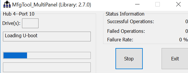

I'm having trouble using the MfgTool to load Linux on an sdCard on an iMX8 EVK. I'm using a Windows 10 host. I have both USB ports connected to the host. I open the file mfgtool2-yocto-mx8-arm2-lpddr4-sdcard-sd2.vbs to launch the manufacturing tool. When I press start, the tool locks up and shows

For latest releases we suggest to use latest MfgTool-UUU, you can download it form here:
UUU 1.2.135 binary (uuu.exe is for Windows and uuu is for Linux host pc)
Execute the tool in terminal (Linux) or PowerShell as administrator (Windows) with the following command:
Windows:
.\uuu.exe -b sd_all <bootloader>.bin <rootfs>.sdcard
Linux:
$ sudo uuu -b sd_all <bootloader>.bin <rootfs>.sdcard

aelder
I see
e:\Downloads\L4.9.88_2.0.0_images_MX8MQ>c:\Apps\nxp\uuu.exe -b sd_all imx-boot-imx8mqevk-sd.bin-flash_evk fsl-image-qt5-validation-imx-xwayland-imx8mqevk.sdcard
uuu (Universal Update Utility) for nxp imx chips -- libuuu_1.2.135-0-gacaf035
Success 0 Failure 0
1:1 1/ 1 [=================100%=================] SDP: boot -f imx-boot-imx8mqevk-sd.bin-flash_evk
and then nothing else happens. Is that expected?

aelder
Yuri, that image worked! I am up and running!
7,362 Views
aelder
For the record, I just used balenaEtcher to copy the sdcard image to an sdcard and then I plugged the sdcard in to the EVK, made sure the dip switches were set correctly and it booted fine.
