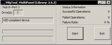

I am trying to create a fully automated test solution for a product which is currently using mfgtool.exe. We have created a script to run the program and it loads up perfectly, however it is requiring someone to press the start and stop buttons / commands. Is there any way to do it whether it be through system exec or command prompt to be able to simulate the clicking of the start button?

colinwyper
Hi there,
I have tried but it doesnt appear to do much on mines. Not sure if ive done something wrong but i just get a blank screen when i launch mines.
So i've created a script for the board i am looking to program. When i run it normally i get the following window
When i click start it runs and works so i know the script i've created is working
However when i add in -noui i get the following:
Sometimes it closes and sometimes it just stays open. Doesn't really give any indication as to whether its worked or not.
This is the code from the .vbs:
Set wshShell = CreateObject("WScript.shell")
wshShell.run "mfgtool2.exe -noui -c ""linux"" -l ""NAND Flash""  -s ""board=sabreauto"" -s ""6uluboot=evk"" -s ""nand=nand"" -s ""6uldtb=14x14-evk"" -s ""nanddtb=gpmi-weim"" -s ""part_uboot=0"" -s ""part_kernel=1"" -s ""part_dtb=2"" -s ""part_rootfs=3""   "
Set wshShell = Nothing
How do i get mines to display like yours? Is there anyway for it to display the status like it does on the user interface? Even just messages of the status as it stands i don't know what state it is in.

colinwyper
I've tried on another pc and it just does the exact same. Can i ask would you be able to send me your programmer folder? Just incase there is something with the one that i've downloaded.
Kind Regards
Colin
4,492 次查看
colinwyper
Just to let you know, I asked my colleague for his version of the programmer and i then done what was asked and it worked first time.
Must have something to do with the library version as this was version 2.5.1 and it worked yet 2.6.2 doesnt
But thank you for all your help
