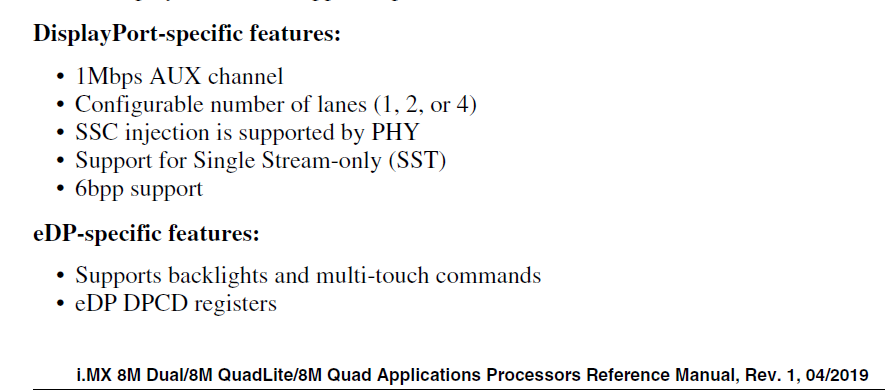

Hi, everyone.
I am reviewing IMX8MD and IMX8MQ.
I'm reviewing eDP and MIPI-DSI to use dual displays, but there's too little data on eDP.
I would like to know if 2-lane eDP is supported in IMX8MD or IMX8MQ.
If 2Lane eDP is supported, I would like to receive schematics and software.
Thank you.

Rita_Wang
Do you mean display on one screen? I see that in our RM.
Display.PNGSchematic we only the it on our website Design Files for the i.MX 8M Evaluation Kit (EVKB)
For the software you can refer to our BSP, there is epd device tree you can refer to .
