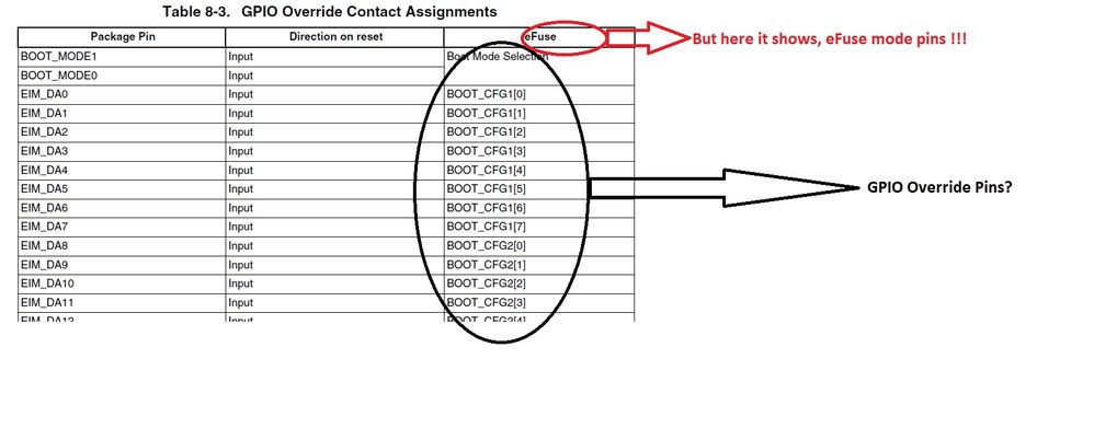

mohammedazlum
Dear Yuri,
I have checked 8.3.2 GPIO Boot Overrides in RM. Please confirm below image.
Azlum
6,904 Views
Yuri
This is just a terminilogy :
package pins, named EIM_DAx (also called as GPIO overridepins),
and BOOT_CFGy as logical name of boot fuses.
~Yuri.
