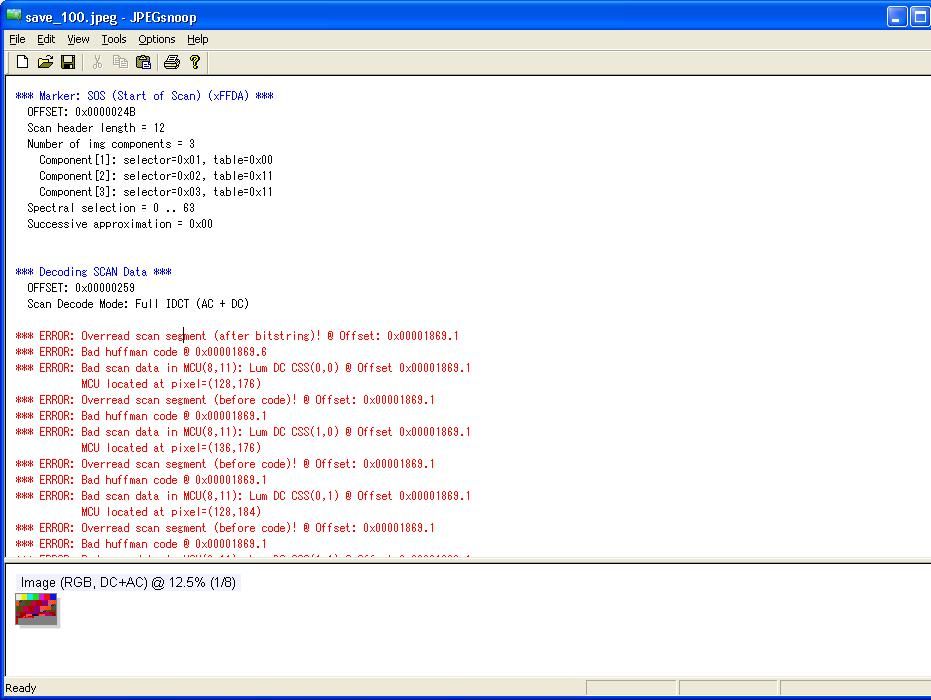

weideding
hi, i am also facing this problem:
i am using vpu mjpeg encoder features on mx51 linux, but the format of .jpg file generated from vpu is not correct, so that rtp cannot use mjpeg:
gst-launch -e videotestsrc ! mfw_vpuencoder codec-type=7 ! multifilesink location=save_%d.jpeg
  use jpegsnoop.exe to check save_x.jpg, there are lots of errors, can any people help me? thanks.snoop_show_errors.JPG
