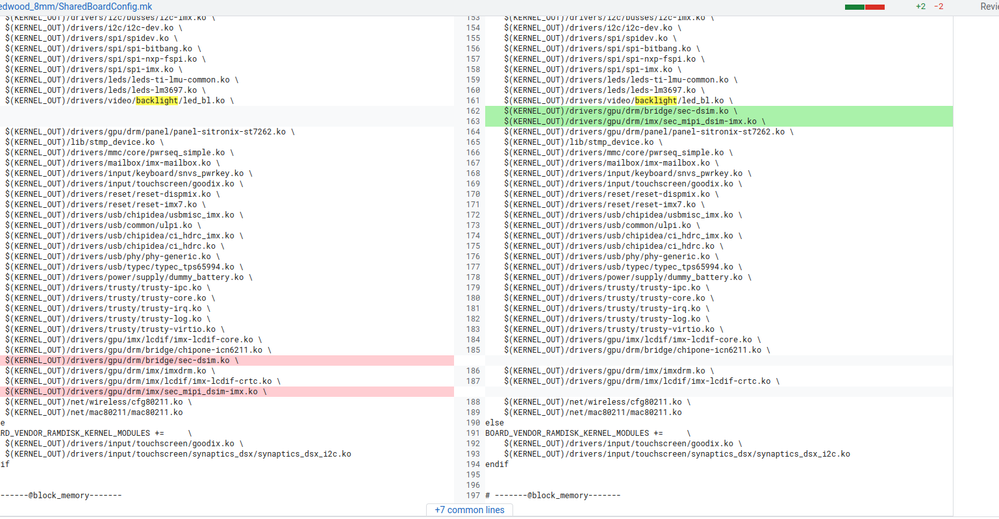

bensonwu
 ****** Latest Update ******
The problem SEEMED solved by our trials.
Debug history
1) We try to remove the followings in dtsi
port {
			st7262_input: endpoint {
				remote-endpoint = <&bridge_out_dsi>;
 Then st7262 driver can be probed correctly .
However , in our platform, we need st7262 (panel , spi interface) and icn6211 (as a bridge between st7262 and imx8mm, mipi_dsi devices) driver which must function normally. we suspect the problem is caused by the remote-endpoint of st7262 port(bridge_out_dsi) cannot be retrieved correctly .  (please refer to the following dts)

 So we try to adjust loadable module sequence in Sharedboardconfig.mk : move mipi dsi bus driver and its related before st7262 & icn6211 driver  , then everything seemed back to normal
Screenshot from 2023-06-14 18-36-18.pngScreenshot from 2023-06-14 18-36-18.png
My question , why the same SharedBoardConfig.mk work at Android 12 but failed at Android 13?
