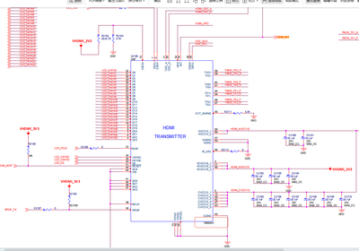

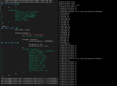

Imx6ull debugs hdmi and uses SiI9022A chip. Now hdmi is not on, and the device tree configuration is as follows. Excuse me, what should I do?

Why you comment the clocks in lcdif node?

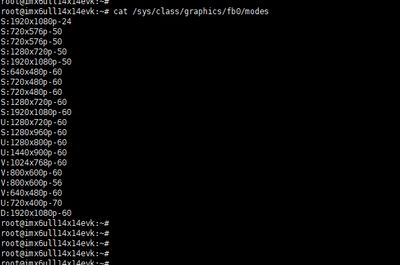

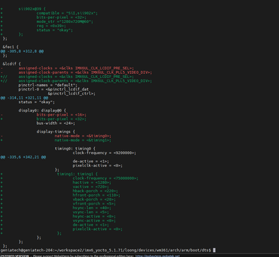

xiang_1001
Now this configuration, hdmi is still not displayed.

Zhiming_Liu
Hi @xiang_1001
Please refer the evk setting about sii902x, then make sure the the interrupt and lcdif hardware is  working as expect
