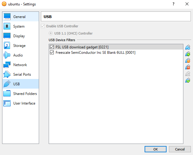

Ypi
UUU flash from virtual machine ubuntu works now when I enabled usb from VM settings.
But I still want to flash from windows if it's possible.
