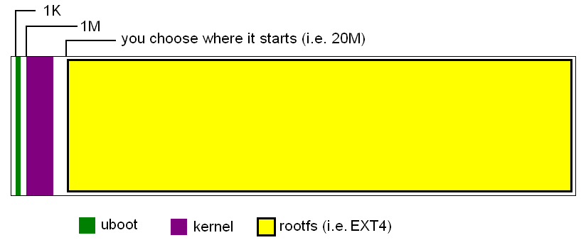

I was building a image by LTIB and flash into microSD, but there is no any output on my screen.
The following is my step:
1. Using ubuntu virtual machine  image offered by FreeScale imx53 QSB DVD.
2. run litb and change the settings
  1. imx25_stack   ->  imx5x
  2. u-boot : mx53_loco
others use the default value.
And I have the files:
<ltib>/rootfs/boot/u-boot.bin
<ltib>/rootfs/boot/uImage
<ltib>/rootfs.jffs2
3. mount jffs2
  1. modprobe  mtdblock
  2. modprobe mtdram total_size=5120 erase_size=256
  3. dd if=rootfs.jffs2 of=/dev/mtdblock0
  4. mkdir jffs_dir
  5. mount -t jffs2 /dev/mtdblock0 jffs_dir
4. copy file to microSD, named /dev/sdb
  1. dd if=rootfs/boot/u-boot.bin of=/dev/sdb bs=512
  2. dd if=rootfs/boot/uImageof=/dev/sdb bs=512 seek=2048
partition:
  1. fdisk /dev/sdb
  2. u
  3. n
  4. p
  5. 1
  6. 8192
  7. <enter>
  8. w
copy rootfs.jffs2
  1. mount /dev/sdb /mnt/hgfs
  2. cd jffs_dir
  3. cp -rpa * /mnt/hgfs
  4. umount //mnt/hgfs
  5. eject /dev/sdb
Are any step is wrong? Please tell me, thanks.

About partition, I use the commands:
partition:
  1. fdisk /dev/sdb
  2. u
  3. n
  4. p
  5. 1
  6. 8192
  7. <enter>
  8. w
Does the partition table match the picture?
Thanks.

KrishnaPavan
When you get MX53-LOCO U-Boot>>
Can you do a "printenv" and add the log as a text file(easy to have a look at).
Are you sure that you placed your SD_Card in a proper slot?
Are you sure, If there are any configuration Switches, You have set them to boot from SD/MMC?
Regarding SD Card Partitions::
Follow this ( Image by Daiane )
6,229 Views

6,229 Views
KrishnaPavan
Hi Deanhuang,
Supply necessary environment variables.
When it asks for "Hit any key to stop auto boot" do it and set the environment variables as required and provided in the User's guide.
link_in_above_post
Is irrelevant as that is a problem with the Serial Cable.
Regards :: Krishna Pavan
