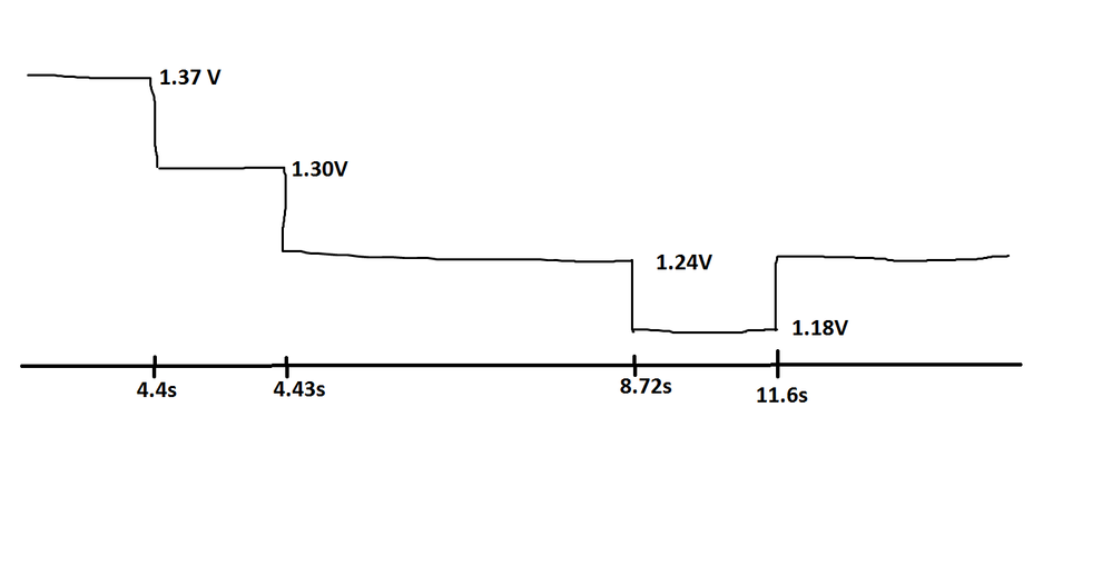

christophe
Contributor V
Hi Chip,
After comparing signals on sabresd and our board, it appears voltage is enough strange on vdd_soc. Voltage on this rail must be regulated at 1.375 V.
Here's Vdd_soc voltage. Start of the boot equals 0 second.
After, if the cpu doens't crash, vdd_soc voltage goes on to vary and is rather never steady at 1.375V. We use a pmic MMPF0100F0EP.
SW1CFB signal on pmic shows activity as it would try to regulate something, but target voltage is seemingly not readched.
Rgds,
Christophe
4,804 Views
igorpadykov
Hi Christophe
vdd_soc voltage may vary with processor loading (Linux
uses DVFS technique), this is normal (one can check with Datasheet
allowable levels).
For test one can try to lower core max operating frequency with
Uboot kernel parameter, such for example
arm_freq=800
Also one can try to run ltib in minimal configuration (wthout GUI)
and check if issue will persist. If issue will disappear, then there are
big board noise and ripples, one probably will have to relayout board
or somehow improve filtering.
chip
