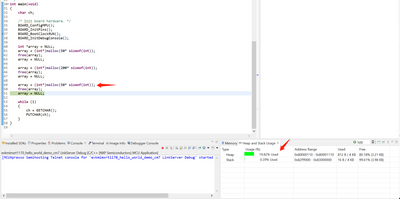

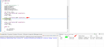

Hello All,
I'am testing dynamic memory usage on imxrt1176 on baremetal. When using standard C malloc() then free() functions, the allocated space is not released with the free function. The heap do not decrease:

Hi @ahmedhrabi ,
There's the feedback from the AE team.
The Usage of 'Heap and Stack Usage' displays the maximum value which allocated, the usage value will update when the current allocated space larger than the previous allocated space, not update when the current allocated space smaller than the previous allocated space. In fact, the allocated space is released with the free function.
Some test results is below:
(1) array = (int*)malloc(50* sizeof(int));   the Usage displays 5.18%.
(2) array = (int*)malloc(200* sizeof(int)); the Usage will update as 19.82%.
(3) array = (int*)malloc(50* sizeof(int)); the Usage will remain as 19.82%, which is consistent with the applied maximum space before.
