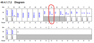

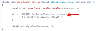

Could you please advise what could cause this behavior, where the TDRE register is consistently 0?

From my side, I searched with the key words 'zephyr, 2.7.1, mimxrt1060' your mentioned, https://github.com/zephyrproject-rtos/zephyr/blob/zephyr-v2.7.1/boards/arm/mimxrt1060_evk/mimxrt1060...
- For LPUART_GetStatusFlags(config->base) & LPUART_STAT_TDRE_MASK, please see below comments.
https://github.com/zephyrproject-rtos/zephyr/blob/2eb8cfb7f5084d040725dc0f4c61b526fa40b8f0/drivers/s...
 * @brief Gets LPUART status flags.
 * This function gets all LPUART status flags. The flags are returned as the logical
 * OR value of the enumerators @ref _lpuart_flags. To check for a specific status,
 * compare the return value with enumerators in the @ref _lpuart_flags.
 * For example, to check whether the TX is empty:
 * @code
 *     if (kLPUART_TxDataRegEmptyFlag & LPUART_GetStatusFlags(LPUART1))
 * @endcode
 * @Param base LPUART peripheral base address.
 * @return LPUART status flags which are ORed by the enumerators in the _lpuart_flags.
uint32_t LPUART_GetStatusFlags(LPUART_Type *base);
And the definition of LPUART_STAT_TRDE as below:
#define LPUART_STAT_TC_MASK                      (0x400000U)
#define LPUART_STAT_TC_SHIFT                     (22U)
/*! TC - Transmission Complete Flag
 *  0b0..Transmitter active (sending data, a preamble, or a break).
 *  0b1..Transmitter idle (transmission activity complete).
#define LPUART_STAT_TC(x)                        (((uint32_t)(((uint32_t)(x)) << LPUART_STAT_TC_SHIFT)) & LPUART_STAT_TC_MASK)
#define LPUART_STAT_TDRE_MASK                    (0x800000U)
#define LPUART_STAT_TDRE_SHIFT                   (23U)
/*! TDRE - Transmit Data Register Empty Flag
 *  0b0..Transmit FIFO level is greater than watermark.
 *  0b1..Transmit FIFO level is equal or less than watermark.
#define LPUART_STAT_TDRE(x)                      (((uint32_t)(((uint32_t)(x)) << LPUART_STAT_TDRE_SHIFT)) & LPUART_STAT_TDRE_MASK)

I apologize for not describing the issue clearly earlier. I would like to clarify the situation regarding the behavior of the UART module's TDRE flag after initialization.
After boot-up and initializing the UART module, the TDRE flag fails to be set to 1 successfully 5-6 times out of 100. I am trying to understand why this happens.
Could you please provide any insights or suggestions on what might be causing this issue?

I am confused again why boot-up problem is related to UART according to your point of view, it seems it boot from XIP(FlexSPI Nor Flash) not serial download.
TC - Transmission Complete Flag, TDRE - Transmit Data Register Empty Flag.
it is needed to check why TDRE is happened from application.

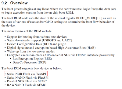

Yes, my custom boards are boot from the nor flash. Initially, I suspected that the boot failure issue was due to incorrect flash-related settings. However, after further clarification, I found that during boot failure, the program actually gets stuck in the mcux_lpuart_poll_out function's while loop. The failure always occurs when trying to print the first line of the debug log. This leads me to wonder about the cause of TDRE being 0 after UART initialization, since the reset value of TDRE should be 1.

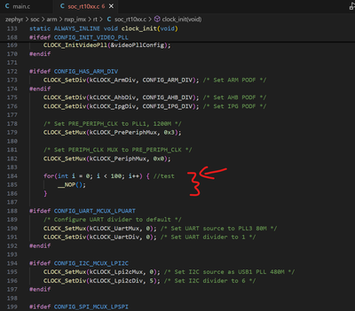

Additionally, I’ve been experimenting with the SDK sample code and found that disabling the clock gate for UART1-UART8 before setting the UART source clock can prevent the issue. Could you please explain why disabling the clock gate could resolves the issue?
As I mentioned earlier, I also tried introducing a 100 NOP delay before setting the source clocks for all modules, but this solution does not work consistently across all boards.

' disabling the clock gate for UART1-UART8 before setting the UART source clock can prevent the issue.'
I am able to give comments, I try to understand if you can help give the source code to describe in details.
About this boot-fail case, I am still confused if the root casue is from print/UART which seems be 100% issue as your mentioned.

I wanted to share an update.
I added a delay time (100 NOPs) before setting the source clock for the UART.
It seems to have fixed the issue of the system getting stuck in the while loop of mcux_lpuart_pool_out during boot-up.
Attached is the code for my clock initialization process.
Thank you.

    CLOCK_InitSysPfd(kCLOCK_Pfd0, 0x12U);
    CLOCK_SetDiv(kCLOCK_Usdhc2Div, 0U);
    CLOCK_SetMux(kCLOCK_Usdhc2Mux, 1U);
    CLOCK_EnableClock(kCLOCK_Usdhc2);
#endif
#ifdef CONFIG_VIDEO_MCUX_CSI
    CLOCK_EnableClock(kCLOCK_Csi); /* Disable CSI clock gate */
    CLOCK_SetDiv(kCLOCK_CsiDiv, 0); /* Set CSI divider to 1 */
    CLOCK_SetMux(kCLOCK_CsiMux, 0); /* Set CSI source to OSC 24M */
#endif
#ifdef CONFIG_CAN_MCUX_FLEXCAN
    CLOCK_SetDiv(kCLOCK_CanDiv, 1); /* Set CAN_CLK_PODF. */
    CLOCK_SetMux(kCLOCK_CanMux, 2); /* Set Can clock source. */
#endif
#if !(defined(CONFIG_CODE_FLEXSPI) || defined(CONFIG_CODE_FLEXSPI2)) && \
    defined(CONFIG_MEMC_MCUX_FLEXSPI) && \
    DT_NODE_HAS_STATUS(DT_NODELABEL(flexspi), okay)
    CLOCK_DisableClock(kCLOCK_FlexSpi);
    CLOCK_InitUsb1Pfd(kCLOCK_Pfd0, 24);
    CLOCK_SetMux(kCLOCK_FlexspiMux, 3);
    CLOCK_SetDiv(kCLOCK_FlexspiDiv, 2);
#endif
    /* Keep the system clock running so SYSTICK can wake up the system from
     * wfi.
    CLOCK_SetMode(kCLOCK_ModeRun);
