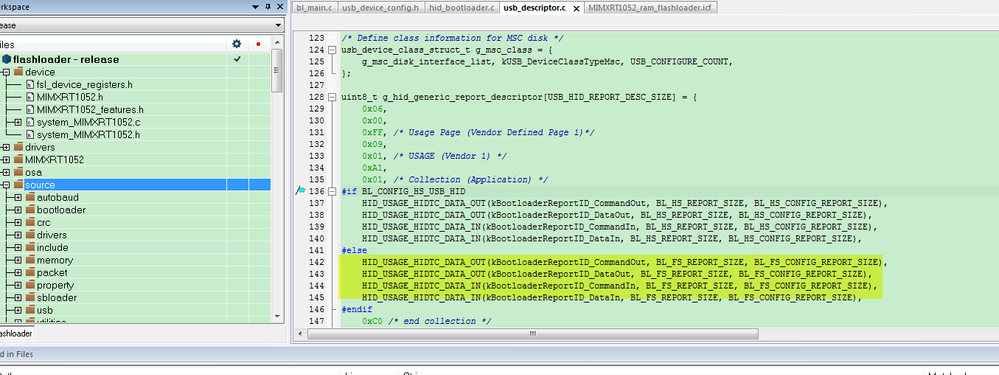

I think I figured out all of the changes to make the flashloader work with USB full-speed.
I've only done brief testing to make sure it works basically, but I will post the changes here in case someone else runs into this.

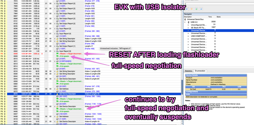

The device fails to even enumerate on the PC, this is before any PC software can communicate with the board. So MFGtool is not possible to test.
 I am using a Beagle 480 protocol analyzer to debug the USB traffic between the EVK/isolator and the PC.
Booting one of the sdk USB samples through the isolator, I can see the device enumerates correctly, so it seems to specifically be the USB stack of MCUBoot.

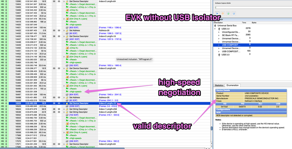

Here are some USB trace captures from the EVK both with and without the USB isolator in place.
I should correct my previous post, it is the FlashLoader that is failing, not MCUBoot.  This is after booting to MCUBoot uploading the FlashLoader and re-enumerating to allow programming.
valid without isolator
full-speed failure with isolator:
There are 5 places that need to be modified in the flashloader code:
