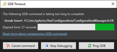

We are using an MIMXRT1051 for some of our products currently. But for simplicity we can use the IMXRT1050-EVKB development board for this topic. Debugging works via SWD via J-Link with a seemingly outdated QSPI driver, via VisualGDB and finally via Visual Studio in C++.
All of this somewhat works, but the debugging is terribly slow and even sometimes just dies (especially compared to our STM development). It's 25 seconds to several minutes from starting debug until hitting the first breakpoint in main.
This is why I wanted to ask here if someone has better ways of debugging these controllers out of MCUXpresso?

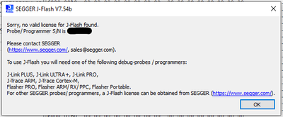

Besides, J-Flash only works on J-Link+ - and not on the regular J-Link probes. Our hardware (department) is using QSPI instead of hyperflash because of pricing iirc. We already have several prototypes using this setup by now, too.

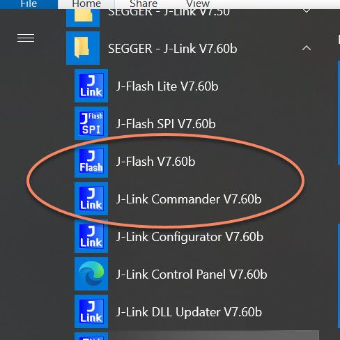

   So, if you don't want to use the  IDE, two method:
  1. use JLINK related software to download directly.
  2. enter serial downlod mode, then use the MCUbootUtility, Secure provisional tool, or MFG tool to download.

We have one J-Link+ and with this one, it's possible to directly flash via J-Flash. With the 'regular' ones it's sadly not working. I'll also attach some debugging commands with timing.

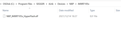

    To the RT1050, the Segger new driver, just add the hyperflash.elf in
C:\Program Files\SEGGER\JLink\Devices\NXP\iMXRT105x
That's why you can't make it work with your QSPI flash, but don't worry, just as you said, you can use the RT-UFL, it can support the RT1050 QSPI.

  If you are using the Segger JLINK, you totally can use the JLINK command or the JFLASH tool to download it directly, you just need to provide the app firmware. This method you don't need the IDE or other tools, Segger tools and debugger can support it directly.
The used firmware, to MIMXRT1050-EVKB, the default is hyperflash, you can find it from the Segger driver install path:
