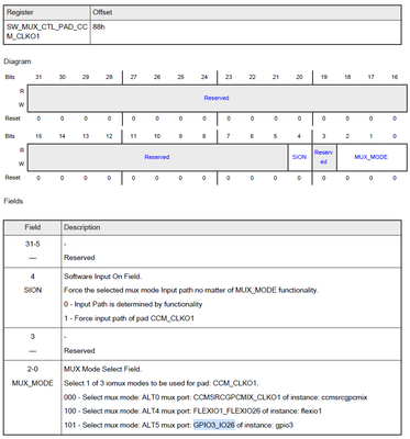

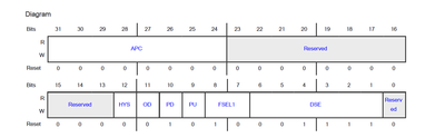

I'm trying to port a pin as GPIO and setup the register value according to IMX93RM document,
but I didn't see any control bit definition about PUE (pull up/down)
where can I find the register value (red text) definition as the source code setup value as below ?

joanxie
pls refer to the SW_PAD_CTL_PAD_CCM_CLKO1

Sanjay_Pandey1
This is bit confusing, actually there is two register.
  • SW_MUX_CTL_PAD_CCM_CLKO1 SW MUX Control Register (SW_MUX_CTL_PAD_CCM_CLKO1)
  • SW_PAD_CTL_PAD_CCM_CLKO1 SW PAD Control Register (SW_PAD_CTL_PAD_CCM_CLKO1)
SW_MUX_CTL_PAD_CCM_CLKO1 is used for selecting the function of the pin e.g. UART,GPIO,SPI,I2C , where as SW_PAD_CTL_PAD_CCM_CLKO1 is used to configure other properties of the pin for example Pull Up, Pull Down if the signal to pin is GPIO.
SW_PAD_CTL_PAD_CCM_CLKO1 is defined in .dts file where as SW_MUX_CTL_PAD_CCM_CLKO1 is already handed in imx93-pinfunc.h file, which is in same folder of dts.
#define MX93_PAD_CCM_CLKO1__CCMSRCGPCMIX_CLKO1 0x0088 0x0238 0x0000 0x0 0x0
#define MX93_PAD_CCM_CLKO1__FLEXIO1_FLEXIO26 0x0088 0x0238 0x0000 0x4 0x0
#define MX93_PAD_CCM_CLKO1__GPIO3_IO26 0x0088 0x0238 0x0000 0x5 0x0
These three macro defines three alternate option bellow is the description of each value of the tuples.
* The pin function ID is a tuple of
* <mux_reg conf_reg input_reg mux_mode input_val>
