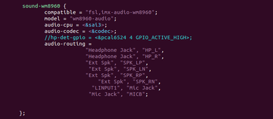

  My platform is imx93
  Linux :6.1.22
  I am debugging the wm8960 audio codec:
  I running the command:aplay 1.wav
  It has no  sound and has no error
root@imx93evk:~# aplay 1.wav
Playing WAVE '1.wav' : Signed 16 bit Little Endian, Rate 44100 Hz, Stereo

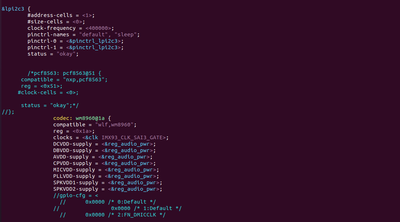

 My dts is as follows:
The whole dts ,and log is as follows:

I want to play from the headphone,Can you help having a look the amixer
I run the command as follows,then has no sound
aplay -D hw:0,0 1.wav

4,643 Views
5454ty
HI,
   I can play the music ,but i cann't play the music by recording
  My command as follows:
arecord -f cd -d 100 record.wav
aplay record.wav
I can get the signal of sound ,but cann't play the sound of recording

Manuel_Salas
How are you recording the audio?
Do you have a specific device to do it? if yes, could you please share the log of command:
root@imx93evk:~# arecord -l
**** List of CAPTURE Hardware Devices ****
card 0: btscoaudio [bt-sco-audio], device 0: 443b0000.sai-bt-sco-pcm-wb bt-sco-pcm-wb-0 [443b0000.sai-bt-sco-pcm-wb bt-sco-pcm-wb-0]
  Subdevices: 1/1
  Subdevice #0: subdevice #0
card 1: micfilaudio [micfil-audio], device 0: micfil hifi snd-soc-dummy-dai-0 [micfil hifi snd-soc-dummy-dai-0]
  Subdevices: 1/1
card 2: imxaudioxcvr [imx-audio-xcvr], device 0: XCVR PCM snd-soc-dummy-dai-0 [XCVR PCM snd-soc-dummy-dai-0]
  Subdevices: 1/1
card 3: wm8962audio [wm8962-audio], device 0: HiFi wm8962-0 [HiFi wm8962-0]
  Subdevices: 1/1
root@imx93evk:~#
Maybe the file is not being recorded correctly and that is the reason that there is not audio.
In i.MX93EVK the audio is recorded by micfilaudio device.
Also, you can specify the frequency to record and playback.
Salas.

5454ty
root@imx93evk:~#
card 0: micfilaudio [micfil-audio], device 0: micfil hifi snd-soc-dummy-dai-0 [micfil hifi snd-soc-dummy-dai-0]
Subdevices: 1/1
card 1: btscoaudio [bt-sco-audio], device 0: 443b0000.sai-bt-sco-pcm-wb bt-sco-pcm-wb-0 [443b0000.sai-bt-sco-pcm-wb bt-sco-pcm-wb-0]
Subdevices: 1/1
card 2: wm8960audio [wm8960-audio], device 0: HiFi wm8960-hifi-0 [HiFi wm8960-hifi-0]
Subdevices: 1/1
root@imx93evk:~#
How i can do?
