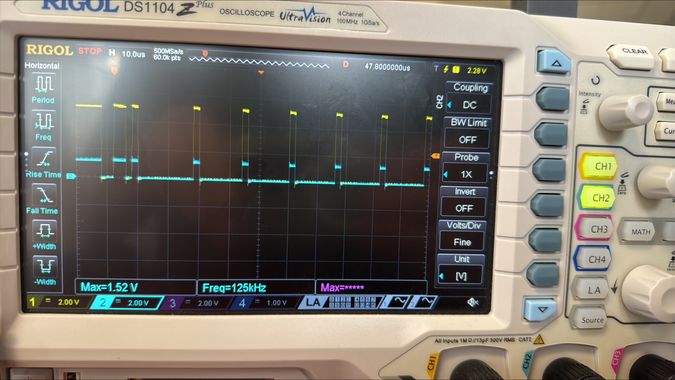

Basically, the problem is that when I start the binary, I see a voltage drop on MOSI signal, with the same configuration there is not a drop on SCK signal.
In the image below you can see:
  • Yellow, MOSI from master side;
  • Violet, SIN from slave side (on a test point);
  • Blue, SIN on the pin GPION_09 SPI3_SIN;

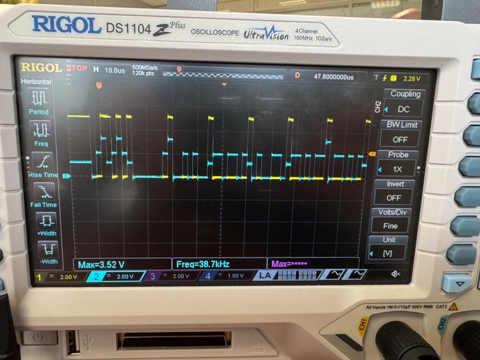

  • Yellow, from master side;
  • Violet, SCK from slave side;
  • Blue, SCK on the pin GPION_09 SPI3_SIN;
As you can see, there is a voltage drop on MOSI and there isn't a voltage drop on SCK.
I have configured the same pin, the same peripheral with M33 core and I don't see this voltage drop.
When I use the LPSPI 4 as master, instead, I have no issue.
Any suggestion?

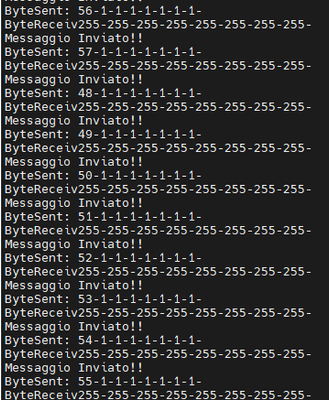

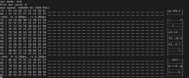

il_ciancio
Hi @pengyong_zhang,
I have runned spidev_test on my spi_slave peripheral.
This is the command:
  • spidev_test -D /dev/spidev2.0 -I100 -S8 -v -s500000.
This is the output:
il_ciancio_0-1748337477892.pngil_ciancio_0-1748337477892.png.
I am not receiving the data, below there is the Master (basically each seconds I am sendin in ASCII 1 to 9):
il_ciancio_1-1748337530395.pngil_ciancio_1-1748337530395.png.

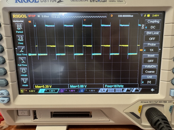

The strange things is that:
  • The image below is the oscilloscope on the MOSI LINE. The yellow signal is MOSI from the MASTER, the blu line is the SIN from the slave.
  • It seems that spidev_test is sending data on the SIN line, while it should be sent on the SOUT line. When spidev_test is killed, there isn't overlapping.
Image (1).jpgImage (1).jpg.
Some question:
  1. Any Idea on this behaviour?
  2. How can I specify to spidev_test to work as slave?
  3. How can i specify to spidev_test to work in half-duplex mode?
Thanks for your time and your support.
