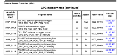

There are definitions for GPC registers in imx-atf
#define
LPS_CPU1
0x114 for imx8mn,mm,mq
#define
LPS_CPU1
0xEC for imxmp
https://source.codeaurora.org/external/imx/imx-atf/tree/plat/imx/imx8m/imx8mp/include/gpc_reg.h?h=lf...
https://source.codeaurora.org/external/imx/imx-atf/tree/plat/imx/imx8m/imx8mn/include/gpc_reg.h?h=lf...
but the offset of LPS_CPU1 was not listed in the Reference Manual neither for imx8mn nor imx8mp, you can see 303a_00ec was skiped in imx8mp Reference Manual.
Quastion: Where can I find the specification for imx8mp for register "0x 303a_00ec"

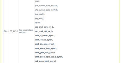

pls refer to the registers as below:
