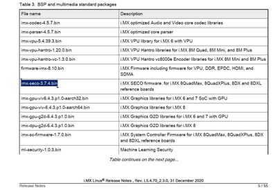

hello,
version: imx-scfw-porting-kit-1.7.0
i want to see SCFW console log, set :
make qx R=B0 B=mek M=1 D=1 U=1 V=1
but SCFW print :
Hello from SCU (Build 5126, Commit 0d54291f, Dec 17 2020 03:06:47)
SCFW: DDR frequency = 1200000000
ROM boot time = 59240 usec
Boot time = 28261 usec
Banner = 9 usec
Init = 8656 usec
Config = 2586 usec
DDR = 11123 usec
SConfig = 273 usec
Prep = 3363 usec
Incorrect SECO FW version 2.5.4 (3.7.4 or later required)
*** Debug Monitor ***
2,029 Views
igorpadykov
Hi Gravity
all versions of software components (like SCFW, SECO e.t.c.) should be aligned
according to Release Notes document for each BSP. Not recommneded to mix them with
other versions:
https://www.nxp.com/design/software/embedded-software/i-mx-software/embedded-linux-for-i-mx-applicat...
igor
