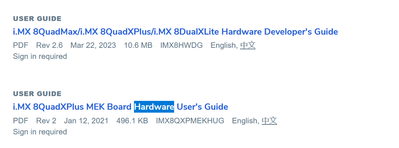

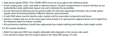

We want to know the length matching requirement of IMX8QXP for MIPI, LVDS, Parallel (For camera), and SDIO lines of IMX8QXP. Please share the requirements.
1,656 Views
Rohith04
@Zhiming_Liu I'm not able to find the trace length matching requirement on this MIPI, LVDS, Parallel (For camera), and SDIO lines in the documents.
1,854 Views
Rohith04
Hi Team,
We couldn't find length-matching requirements of MIPI, LVDS, Parallel (For camera), and SDIO lines in these documents. Please help here.
