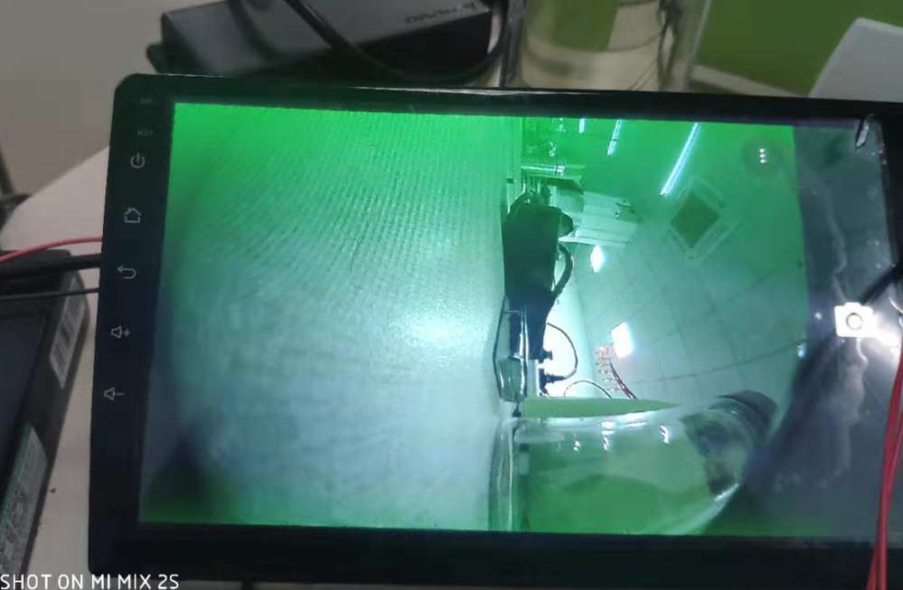

IMX8QXP Android8 camera work well,
but IMX8QXP Android9.0 camera preview color abnormal,like the picture below.
Is it a known platform issues?
Thanks.

xinchuan
hi Xu Ji,
we copy our code from android 8 to android 9,and camera preview start,but green.no your issue.

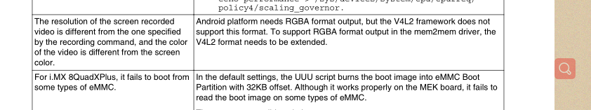

xinchuan
Hello victor,
         The green,red,blue colors are all right.
         I noticed the below  Known issues and limitations in Android™ Release Notes P9.0.0_1.0.2-AUTO-beta,
         Is this the reason our preview looks green?
4,051件の閲覧回数
b36401
As far as I know it supports UYVY and YUYV input format.
4,051件の閲覧回数
b36401
Please make sure that right pixel format is set for the sensor.
