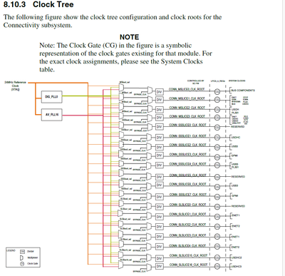

I am trying to understand what path the clock takes to get the ENET1_TXC (125Mhz). Specifically,
  1. Which PLL ( 24Mhz or AV_PLL16 or DIG_PLL0) does get used to generate TXC ?
  2. Which one is the root clock for TXC ? For example CONN_SLSLICE1 or CONN_SLSLICE3_CLK_ROOT for ENET1.
  3. How do I read the values of DIV and SLSlice<>_sel mentioned above?.  I believe all these are done in the SCFW ? If so, can you help me pin point where it is done?
Interestingly, I saw this table too
Does this mean that none of the DIG_PLL0, AV_PLL16 can be changed at all?  That would mean that everything depends  on the 24Mhz clock (its quality and precision) ONLY and the DIV values are hard-coded and cannot be changed?
We believe the input 24Mhz clock fed is error/jitter free. Any chance the SOC might introduce any errors? If so, is there any workaround ? lets say, adjusting any divider/multiplier along the clock tree to make the TXC error within the acceptable levels (50ppm)

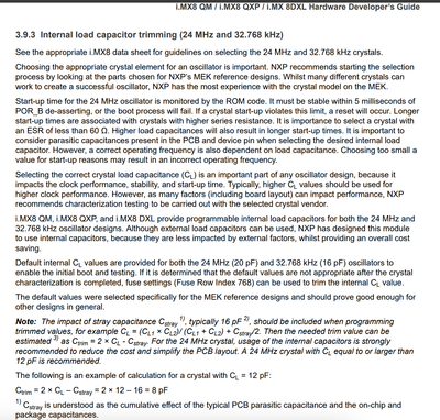

1. The 125MHz is from AV_PLL16. For 24Mhz bypass, it's not used after Ethernet PLL is stable. It's just a transition clock.
2. I don't think modifying the crossover value will solve the problem.
3. Since the hardware design manual's clock jitter requirement for the enet is 50ppm, I don't think there's any need to worry about internal PLL jitter causing this value to be larger.
4. For the 24MHz input design, the following points need to be noted in Hardwarre Developer's Guide. The default setting for internal capactior is BRD_OSC_CAP_TRM_VALUE_24M[3..0]=1010-->20pf. The default values were selected specifically for the MEK reference designs and should prove good enough for other designs in general.
It may have something to do with the setting of this value, after making sure that there is nothing need to adjust with the design of your 24Mhz peripheral circuits. Careful burning thes bits of fuse is required.
Have you measured the 24MHz crystal jitter above the chip's input pins? If it is confirmed that the 24Mhz jitter received by the chip meets the requirements, then the only thing left to adjust are these bits in the fuse.

1. Don't try to write fuse for now, you can use the fuse command in uboot to see the usage.
2. PLLs is internal, can't be measured. Did you measure the TXC output on SOC before? not the PHY side.
