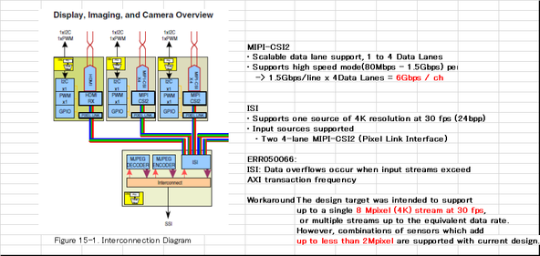

Hello community,
Some community thread were talk about iMX8QM ISI errata
ERR050066: ISI: Data overflows occur when input streams exceed AXI transaction frequency
like this.
8 x 1080p MIPI CSI2 cameras capture in iMX8QM
In this errata
"However, combinations of sensors which add
up to less than 2Mpixel are supported with current design."
mean that
1) 2Mpixel mean that 1920x1080 = 2,073,600 is correct?
2) How about frame rate.1920x1080 @60 or 1920x1080 @30
Does this apply to each channel individually?
Can it capture for 2ch 1920x1080 @60 support?
MIPI-CSI2_01920 x 1080 @60
MIPI-CSI2_11920 x 1080 @60
The other hand, i.MX8QXP_C0 silicon have no errata "ERR050066: ISI: Data overflows occur when input streams exceed AXI transaction frequency"..
Is it support 4K@30 video capture?
devicechresolutionfps
i.MX8QM21920x108060
i.MX8QP21920x1080
60
i.MX8QXP13840x216030

the mipi csi capture max is 6Gbps, so should can support 4k, but we didn't test this, maybe would have issue when capture 4k, only test resolution is 1280x800@30, we didn't test 6Gbps, I think 6Gbps maybe cause some bandwidth issue, I only can say we tested max thoughout is 4x1280x800@30

for ERR050066 , this issue is fixed in imx8qxp C0, for imx8qm, can support 4k@30 on theory, but we don't tested this, only tested 4x1280*800@30Hz successfully, so for 4k@30, if  system loading is heavy, there is something wrong with capture

We will reply to the customer that max capture size of i.MX8QM is 4K@30 are the official specifications.
Is it correct in my understanding that it works at 4k@30 per channel for MIPI-CSI2?
Ishii.
18,066 Views
joanxie
yes, each mipi csi port has this performance

How about color format of tested capture 4x1280*800@30Hz.
It is boundary of ISI limitation.
4x1280*800@30Hz*3Byte(RGB24bit) > 2Mpixel(ISI limit) > 4x1280*800@30Hz*2Byte(YUYV16bit)
Ishii.
18,049 Views
joanxie
only tested YUYV16bit

You say that "only tested 4x1280*800@30Hz successfully, so for 4k@30,"
I understand that only tested 4x1280*800@30Hz successfully,
throughput of this condition is lager than 2Gbps, so iMX8QM capture can support more than 2Gbps.
That is, the ISI limit is not affected, so the maximum supported size is 4K@30.
But if test condition is 4x1280*800@30Hz x 16bit/pixel,
This explanation is not valid. Because throughput of test condition is less than 2Gbps.
Which is correct?
1) Maximum capture size of iMX8QM is unknown.
2) It has no test but it supports 6Gbps, so it will be 4K@30.
Sorry to keep checking back, but we need accurate information on this specification
as it is an important issue that affects product planning.
Ishii.

takayuki_ishii
Contributor V
Hello @joanxie
Thank you for your reply.
I understand that ISI errata050066 does not affect the capture performance of MIPI-CSI2, so MIPI-CSI2 capture max is 6Gbps and it should can support 4k.
Ishii.
18,083 Views
takayuki_ishii
Contributor V
Hello @joanxie
Please teach me a byte/pixel size of capture test for 4x 1280*800@30Hz
If it is 2byte/pixel = YUYV, the data volume for this test is less than 2 Gbps.
4x 1280`800 * 30 * 2byte/pixel = 1.966Gbps
This result does not prove that 4K capture is possible because it falls within the errata constraints.
I would appreciate your immediate attention to this matter.
Ishii.

Hello @joanxie
In Figure 15-1. Interconnection Diagram of Reference Manual IMX8QMRM Rev. 0,
MIPI-CSI2 connect to ISI.
So, MIPI-CSI2 can supports 6Gbps so it can capture 4K@30,
Bat ISI have performance limitation 2MPixel.
I think that it is ok to use i.MX8QXP_C0 silicon because it is fixed this limitation.
But i.MX8QM have no C0 revision.
Is it can really capture 4K@30? to frame memory on DDR?
Best regards,.
Ishii.
18,111 Views
takayuki_ishii
Contributor V
Dear community,
My concern is if the errata ERR050066 will affect the capture with MIPI-CSI2.
If affected, I am concerned that the maximum capture size will be limited.
Please see attached document.
Ishii.
