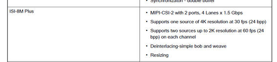

joanxie
ISI is supposed to connect to mipi csi2 interface, pls see the pic as below:

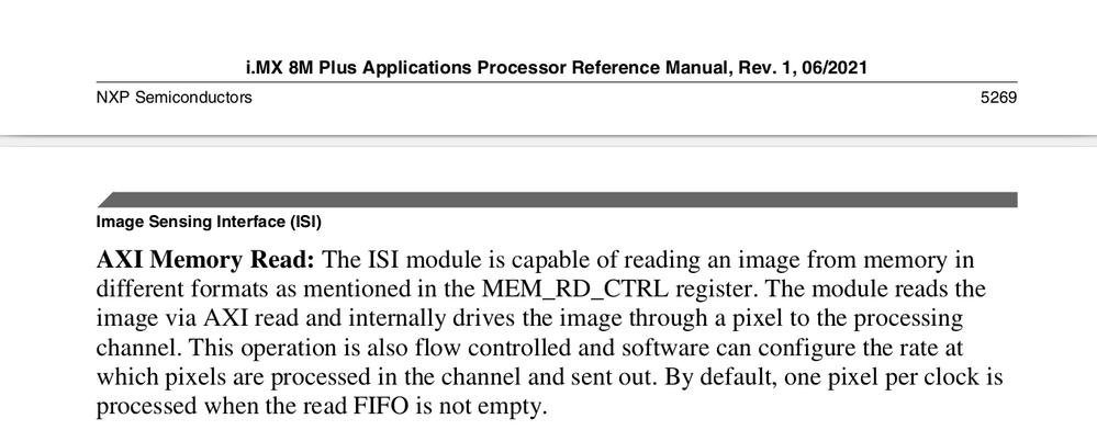

quercuspau
Hello @joanxie ,
I just found this information on TRM:
However, I haven't found any document about how to use this functionality with NXP Linux BSP.
Could you provide this information?

quercuspau
Is there no more information?
15,849 Views
joanxie
I explain again, Memory can be the source of ISI, but current bsp doesn't support this, and I consult local team, no one did this and no sample for this, maybe you need to ask for professional support for your special demands
