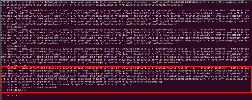

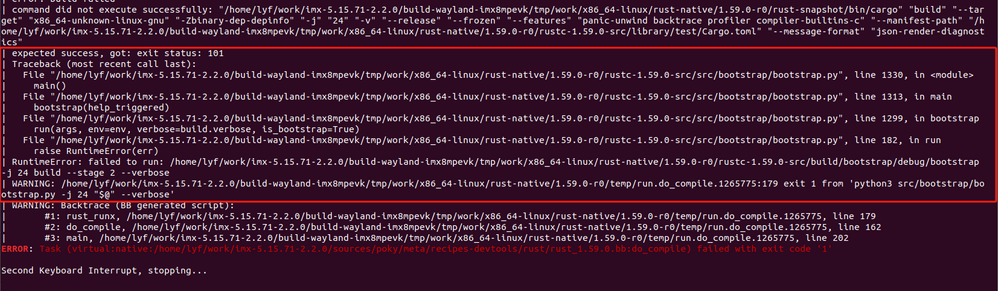

Hello, I encountered this problem when compiling the file system, how to configure to solve it

This information is included in the error message
1,464 Views
Zhiming_Liu
Install all Ubuntu packages(Ubuntu20.04 and later) and then clean this packages, rebuild it.
