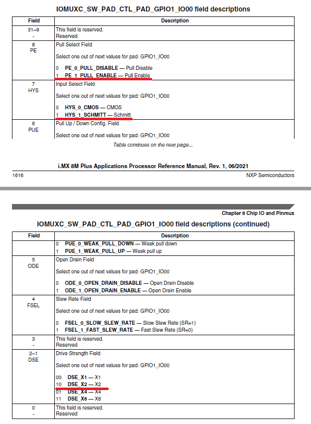

I have imx8mp verdin board and would like to do iomux configuration for GPIOs.
Would like to understand the hardcoded values like 0x184, 0x1c4, and also would be great how can I set default INPUT/OUTPUT and PULL up/down.

3,554 Views
JudyJeo
The decoding of 0x184  in the "MX8MP_IOMUXC_GPIO1_IO00__GPIO1_IO00 0x184>; " is
3,570 Views
Bio_TICFSL
You can add a variable to change the GPIO and not star opened the tool.
