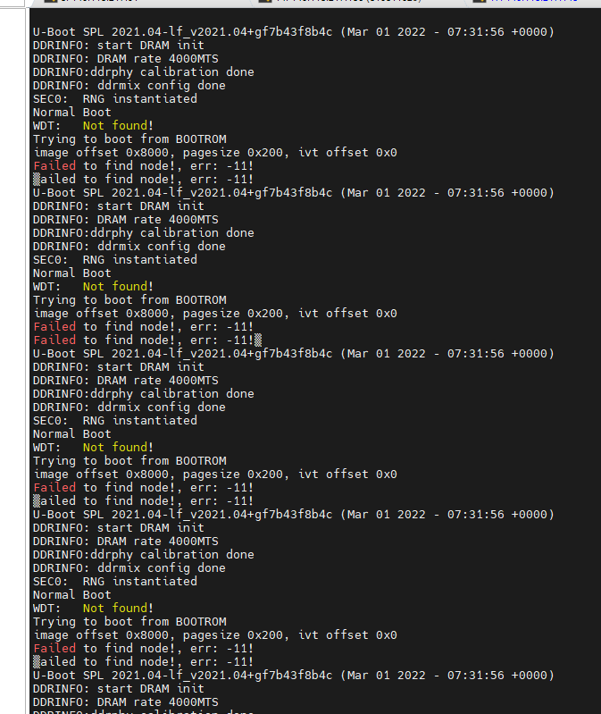

Dear all,
After flashing image into sdcard, I met a problem as shown in figure.
Is there any solution to the problem? thank you.error_code.pngerror_code.png

Hi @ching-julo
Please check the permission and for the ,zip file, and if zip file and uuu.auto are at the same directory.  more details about how to flash and tool, you can refer to Release 1.4.232 · NXPmicro/mfgtools · GitHub

Harvey021
Hi @sml310511029
Can you check on your side which node not found?
and Did you flash boot image that is from our prebuilt image?
Harvey

sml310511029
Hi! @Harvey021
I'm new to this board and the system. Could you teach me how to check which node that is no found?
All I have done so far was to follow the i.MX Yocto Project User's Guide:

ching-julo
May I ask how to flash LF_v5.15.32-2.0.0_images_IMX8MPEVK.zip prebuilt image?
# sudo ./uuu LF_v5.15.32-2.0.0_images_IMX8MPEVK.zip
uuu (Universal Update Utility) for nxp imx chips -- libuuu_1.4.193-0-ge56424c
Wait for Known USB Device Appear...
Error: fail open file: >LF_v5.15.32-2.0.0_images_IMX8MPEVK.zip/uuu.auto
