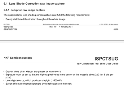

I need a small clarification on  ISP Calibration Tool Suite User Guide Chapter 6 Lens Shade Correction Tool,
As per the manual, I need to adjust Exposure to get highest pixel value in the center of the image is about 220 (for 8 bits per pixel). In this statement it has been mentioned for 8bit per pixel.
In my case I have 12 bits per pixel, so what pixel value in the center of the image I should ensure? and is there any way to find center pixel value using tuning-client tool.?

joanxie
sorry for my delay, I took annual leave last week, I will update this on your new thread
https://community.nxp.com/t5/i-MX-Processors/IMX8MP-ISP-calibration-AWB/td-p/1985987
