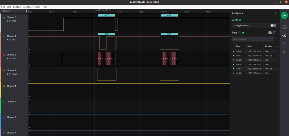

We are having some problems using ECSPI3 at an imx8mp custom board.
Mosi, SCLK and CS seems to be working okay, but MISO is no even working in loopback mode.
Any idea? Is there any kernel problem or special configuration at dts?
Thanks a lot!

We are using imx kernel 5.4.70. The problem seems to be related to CS signal. CS seems to be going inactive between writes and reads, maybe making the slave become unavailable. The problem is shown in this picture:
Captura de pantalla de 2021-09-22 15-45-40.pngCaptura de pantalla de 2021-09-22 15-45-40.png
Any idea will be much appreciated, thank you

Hi Alvaro
what bsp used in the case. May be recommended to try latest Linux 5.10.35_2.0.0
https://source.codeaurora.org/external/imx/linux-imx/tree/?h=lf-5.10.y
with unit test
https://source.codeaurora.org/external/imx/imx-test/tree/test/mxc_spi_test?h=lf-5.10.y_2.0.0
