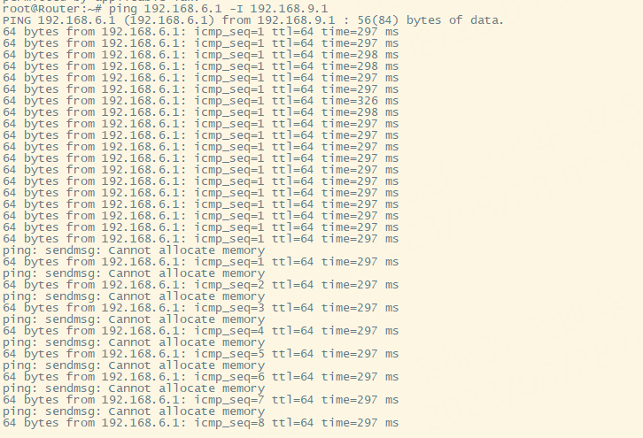

2 board ping each other,ping 192.168.6.1 -I 192.168.9.1,report  “Cannot allocate memory”

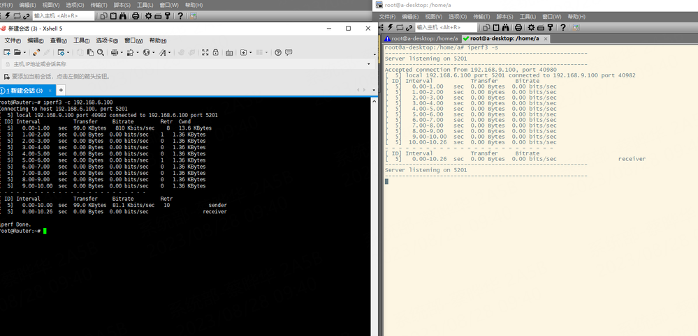

1、Client ping Server,no errors report,packet captured ok
2、Iperf,tcp connected ok,but no data flow,dump packet,found esp header invalid,capture files in attachment。
3、tftp,report timeout,same as iperf test

Hi @kickit
The issue looks like the memory low after network tool running for a while. You might need to have a double check the application that you just applied.
not sure how it related to CAAM.
My suggestion for this issue to have a try for prosupport.
