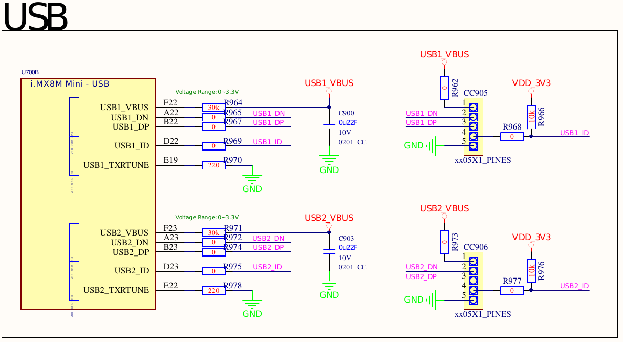

I have a custom imx8mm board with a 512MB DDR4 (K4A4G165WE-BCTD) and a MMC (THGBMNG5D1LBAIL).
I'm trying to program the uboot using UUU software, but stop with that message:

I saw that in ci_udc_probe function (in ci_udc.c file), failed in memalign
/* The QH list must be aligned to 4096 bytes. */
controller.epts = memalign(eplist_align, eplist_sz);
if (!controller.epts){
return -ENOMEM;
In my custom board I didn't have one USB type C, so I follow that topic:
https://community.nxp.com/t5/i-MX-Processors-Knowledge-Base/i-MX8MM-i-MX8MQ-USB2-0-Design-Without-US...
What can be wrong to failed?
Thanks in advance.

FYI, I found the raison why on some board, I got this failure during uuu download.
Verify the state of USB1_ID (pinD22). In my board with issues, this signal was grounded or not floating.
Regards.

Could you share the actual changes you have made?
Also, from the logs seems like you’re using uboot 2020.04 is this correct?
Aldo.

In the schematic, at the beginning I have the usb1 and usb2 configurated in that way.
I don't have any usb connector, but like I have, in another's projects it's work very well.
With that configuration, using UUU tool, In the terminal, the boot stops here:

In the function ci_udc_probe in ci_udc.c  I have
static int ci_udc_probe(void)
struct ept_queue_head *head;
int i;
const int num = 2 * NUM_ENDPOINTS;
const int eplist_min_align = 4096;
const int eplist_align = roundup(eplist_min_align, ARCH_DMA_MINALIGN);
const int eplist_raw_sz = num * sizeof(struct ept_queue_head);
const int eplist_sz = roundup(eplist_raw_sz, ARCH_DMA_MINALIGN);
printf("CRCN %s %d %d %d\n",__FILE__,__LINE__,eplist_align,eplist_sz);
printf("CRCN controller.epts is null\n",__FILE__,__LINE__);
return -ENOMEM;
Then, I change the hardware, inserting the MIC2026, using only the A input/flag/output, and the result is the same.
As you can see, I put a printf ("CRCN controller.epts is null") if the result of the memalign is null.
Another test that I make, was configure  USBNC_n_CTRL2 register (0x32E40204), to change DIG_ID_SEL to 1 (0xDF100000). Result is the same..
Why the boot stops here, in memalign? For me is strange that the USB part of the schematic is bad, if the Uboot SPL start run... Can be another problem regarding DDR, MMC, etc???
Regarding your question about uboot version, I'm using uboot 2020.04.
Thanks.

AldoG
I see that you are not using UBS_OTG_ID pin in your schematic even though it is defined as otg in your device tree and in your schematic, this could be causing the issue, please try by setting one of the 2 modes in device tree by using:
dr_mode = "peripheral";
Even one could use the i.MX6 as reference for this:
https://source.codeaurora.org/external/imx/uboot-imx/tree/arch/arm/dts/imx6qdl-sabresd.dtsi?h=lf_v20...
Aldo.
