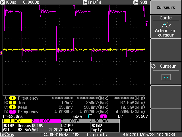

Hello everybody,
I am using the iMX8M-mini to acquire sound from 16 TDM microphones (ics52000).
I am using an external codec to drive a very low-jitter bitclock which is meant to go on both ics52000 and iMX8. However this external codec is not able to generate a frame clock based on 16 channels so I have to do this inside iMX8.
Bellow my device tree (sorry I did'nt find how to include code so I put an image)
For information my mics are working well if I generate bitclock and frame clock from internal IMX8 codec without external codec : (mode SND_SOC_DAIFMT_CBM_CFM)
   simple-audio-card,bitclock-master = <&imx8_dai>
   simple-audio-card,frame-master = <&imx8_dai>
Moreover if I try the mode SND_SOC_DAIFMT_CBM_CFS only the bitclock is generated in that mode
   simple-audio-card,frame-master = <&ics52000>
I don't know what i missed, my bitclock seems clean but it looks like the SAI don't manage to generate frameclock based on it.
For now I am trying 8kHz sample rate which gave me a 4.096MHz bitclock.
Hope you can help me on this issue.

I found the solution to my problem. I needed the Receiver to be asynchronous. The RCR2 bit 31 tickle me.
I added fsl,asynchronous to my SAI config in the device tree

Thank you for your help, I checked my registers and something seems wrong. I will check this and get back to you :
TCR2 = 00000000000000000000000000000000
TCR3 = 00000000000000000000000000000000
TCR4 = 00000000000000000000000000011001
RCR2 = 01000000000000000000000000000000
RCR3 = 00000000000000000000000000000000
RCR4 = 00000000000011110001111100111001
(RCR4 bit 20 should 1 instead of 0 to have 32 bits / word)
