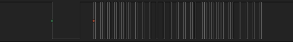

But, I don't understand first and last log.
space 13301060, space 572
Start and End logic is High. (Check signal using logic analyzer)
But, mode2 first and last log is space..
I know 'space' is logic low time.
Is there anything wrong?
Please suggest me how can I supposed to solve.
