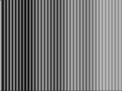

However, when running what we are calling a "hgradient" pattern, OR any other set of bits that are not strictly white or strictly black, we start seeing some artifacts. We are currently receiving these test patterns as raw10 packets, our pipeline currently outputs the data shifted 4 bits to the right in LE format. For example the first pixel is white, the hex storage would be 0xF03F, after LE -> 0x3FF0 and shift by 4, 0x3FF, we get a 10 bit white pixel.
After running v4l2-ctl --stream-mmap --stream-count=1 --stream-to=/tmp/frame.raw and transferring the image off over SCP. We use a little python script to rearrange the 10 bit test pattern to be opened using cv2 libraries.
Output shows
bypass csc
Input fmt Y10P
Output fmt Y10
At a first glance, we can see the initial artifact. The image itself is a true gradient ONLY when removing every 4th pixel from the image. This also occurs with other test patterns as well.
The second and third artifact are a bit more nebulous.
For some reason, every second line's first 4 pixels are always some dark color. Not always zero, but just always really dark.
The last two lines are always black for some reason. However we have reason to believe this is an fpga test pattern generation bug but still something to call out.
Alongside all of that, I recently discovered that when sending NON white/black test patterns, we are receiving CRC errors by directly reading the RX CSI register space during streaming.
I’m seeing an issue where every 4th byte of pixel data appears corrupted, but only on non-uniform images. White and black test patterns look fine. My first thought is that CRC errors could be the cause, but I don’t understand why CRC would ONLY fail on non-uniform.
From the hardware side we seem to be receiving MIPI control packets correctly since images can still be generated. I’m looking for ideas on what other possible error sources might cause the above artifact behavior, and the best ways to approach debugging it.

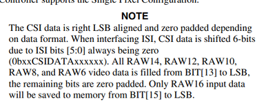

There are also some notes within the documentation which allude to this bit shifting
タグ(1)

Thanks for the clarification, the 4-bit shift requirement is something we already handle in post-processing. That still leaves a set of very repeatable problems that I haven't been able to get useful help on:
  • Every 4th pixel is corrupted for non-uniform images (white/black patterns look fine).
  • On alternating lines, the first 4 pixels are consistently much darker than they should be.
  • The last two lines of every frame are always black (we suspect an FPGA test-pattern issue here).
  • RX CSI CRC errors appear in the CSI registers only when the frame contains non-uniform data.

firstly, you need confirm that your chip is B0 version or C0 version, for B0 which has shift issue,
Oni.MX8QXP B0, when receiving RAW data from CSI, the data will always be shifted to the left for some RAW formats. Here are some examples: RAW10 {valid_data, 4’b0} . After right shift 4 bits, you will get the correct image.
On i.MX8QXP C0, there is a new bit that can fix this alignment, making all bits from received data align starting from bit 0. The table below shows the register and the new bit [31].
you also can refer to the link for raw data capture on imx8qxp
