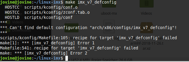

Small curiosite:
Is it possible to download an already built Debian ISO image and simply copy and install it on the NXP IMX7 Dual Sabre processors SD card? as with a raspberry pi

yes, you can download the imx7 demo images, which includes these pre-built demo image, you also can find them in the mfgtool
In section c: Download and make the kernel and dtb
after downloading and unzipping the kernel link
I made the command make imx_v7_defconfig
but I received the errors described on the picture above.

thank you very much, but I was already following the Kane Jiang tutorial in the NXP community to install Debian 8 Jessie Rootfs on the NXP i.MX6ULL EVK board, but the only difference is that I would like to do it on the IMX 7Dual Saber board, I do It  well in the beginning, but up to section c: Download and make the kernel and dtb, I receive compilation errors and I am a little lost.
Here is the link to the tutorial: https://community.nxp.com/docs/DOC-334274.

what error do you get? pls share with me

I mean the software configuration,
in fact i would like to download and make debian linux kernel, a dtb file for the IMX7 Sabre sd of NXP.
And I block at the default software configuration of the Board

for how to find the sw configuration you can refer to the linux refence manual for detailed module,. for yocto, you can refer to the traning as below, tell you how to find the menu configuration
https://community.nxp.com/docs/DOC-95045

what  configuration do you mean? for HW or SW?
