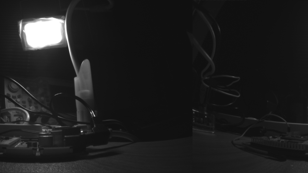

ziain
Hi igorpadykov
   Can you also help me about the parallel mode problem?It like a image rolling problem.You can reference the bmp file which i haved upload.
3,352 Views
ziain
Hi igorpadykov
   This reference cant sovle my problem.If I ignore the CRC error,I will get a error pixel arrange.When I ignore the CRC error,the IMX6 will get a frame each about 1~2 second,but I set the camera sensor output  is 120fps.What cause this problem?
   Now I have a new problem in testing the sensor with dvp mode.I attach the sensor on IPU_CSI0,the solution is 1280*720,ouput is RAW10,fps is 60.
Beacuse the IMX6DL cant overlay the bayer format to the lcd,I cut the pixel arrange that the RAW10 to RAW8 ,just pick the High 8 bit.And I make the to a grey scale BMP file to observed.The bmp look like dislocation.I  change the sensor VTS to reduce the fps and attempt to  sovle it ,but it cant do that.How can I do?
